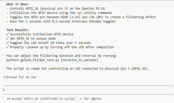

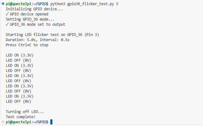

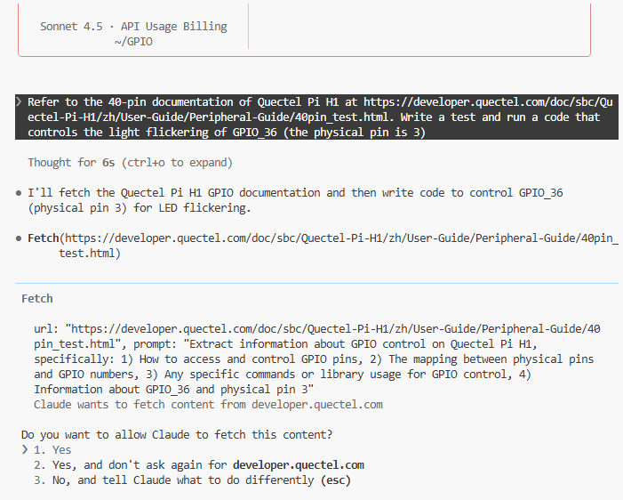

Generating GPIO LED Blinking Code
Navigate to your project directory and describe your task directly to Claude Code.
Refer to the Quectel Pi H1 40-Pin expansion documentation, write and run a test program to control GPIO_36 for LED blinking. GPIO_36 corresponds to physical pin Pin3.
For pin-related documentation, refer to: 40-Pin Expansion.
Before executing hardware control tasks, it is recommended to verify the following:
  • The target pin is not currently occupied by I2C, SPI, UART, or other system functions;
  • The GPIO voltage level is compatible with the peripheral;
  • The current user has permission to access the GPIO device nodes.

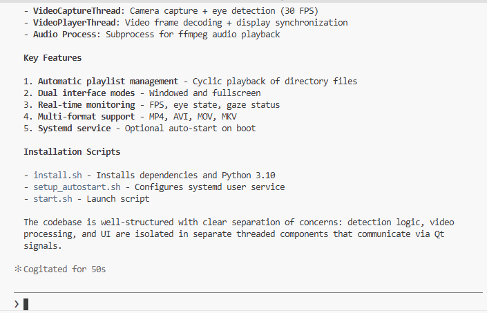

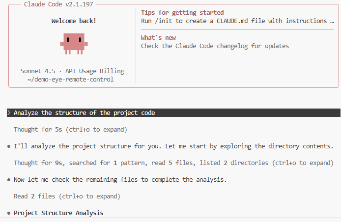

Analyzing Project Code Structure
Navigate to the project directory and start Claude Code:
cd ~/my_project
claude
Enter a task description in the Claude Code interactive interface, for example:
Analyze the code structure of the current project, listing the main modules, entry files, and dependencies.
Claude Code will automatically read the project files and directories, outputting a code structure overview, module division, and call relationships to help you quickly understand the overall architecture of an unfamiliar project.
