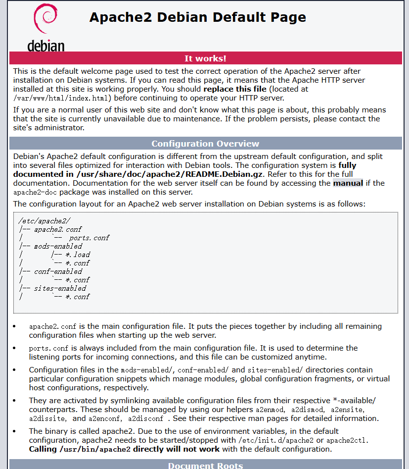

Test whether Apache has been installed successfully
  1. Access through the computer browser within the same network:
http://Your device's IP address
If everything is normal, you will see the default page of Apache.
