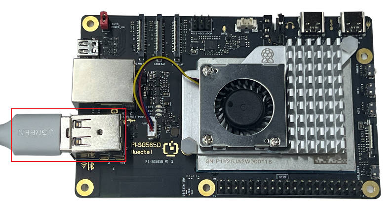

Component Physical Reference

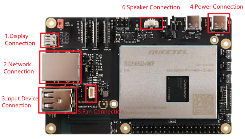

Hardware Connection
Complete all hardware connection steps below. The numbering matches the interface diagram:

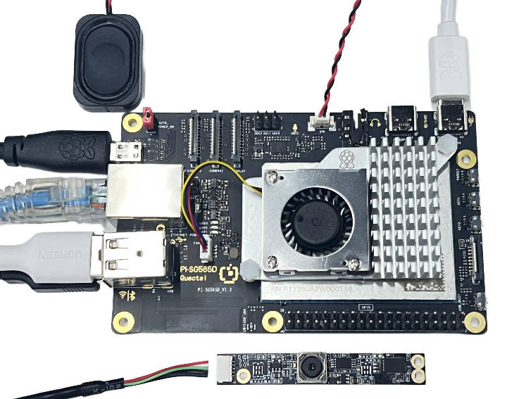

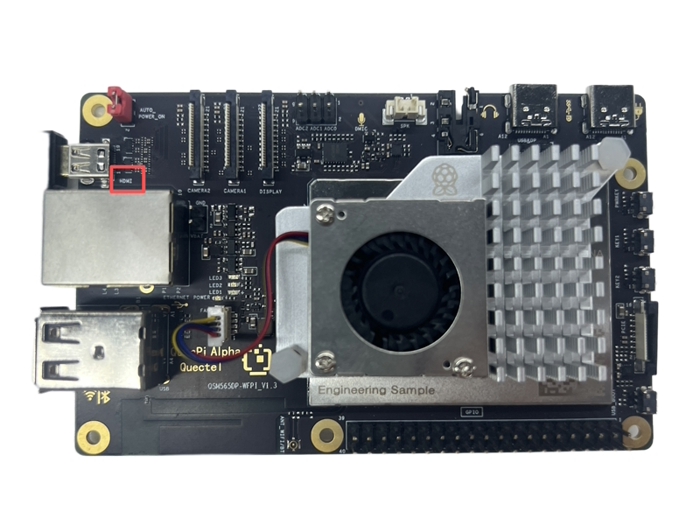

Display connection: Connect one end of the Micro HDMI cable to the Micro HDMI port on the smart single-board computer, and the other end to the HDMI port on the monitor.

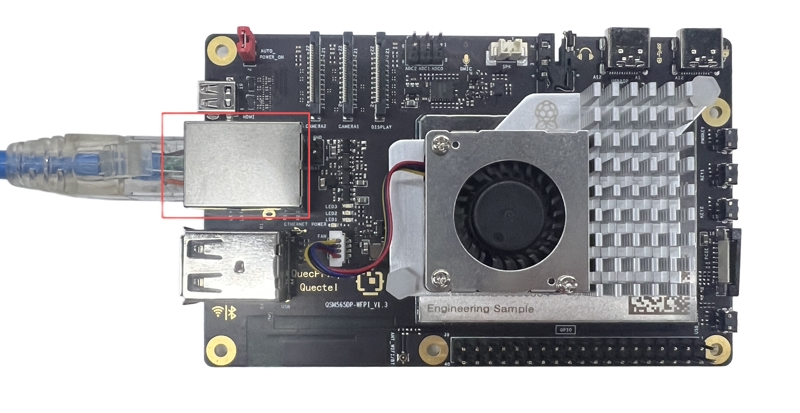

Network connection: Connect one end of the Ethernet cable to the Gigabit Ethernet port on the smart single-board computer, and the other end to the router's port (make sure the router is connected to the internet).

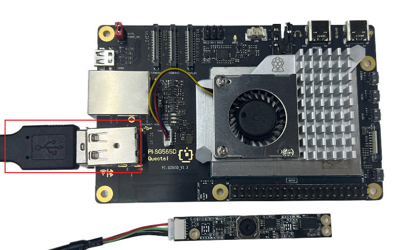

Input device connection: Connect USB keyboard and mouse to the USB ports on the hub, then connect the hub to a USB port on the smart single-board computer. For wireless devices, insert the receiver into a USB port on the hub. Then connect the OV5693 camera module to another USB port on the smart single-board computer.

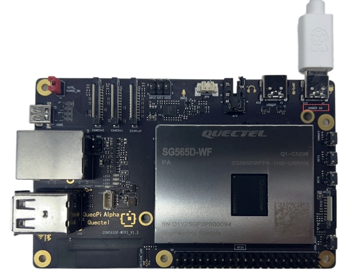

Power connection: Connect the USB-A end of the power cable to the power adapter, and the USB-C end to the power port on the smart single-board computer (usually labeled POWER IN).
Heat sink fan connection: First, insert the cooling fan's ribbon cable into the FAN slot of the smart single-board computer. Then, fix the two ends of the heat sink into the reserved holes on the board.

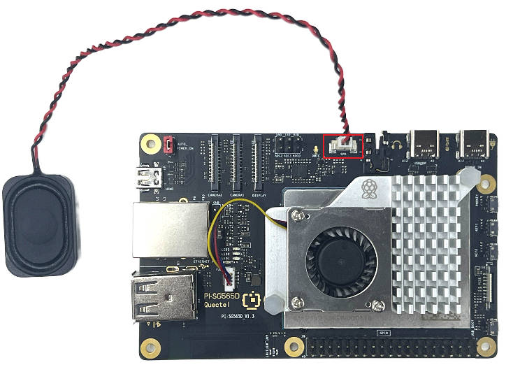

Speaker connection: Connect the 2PIN PH1.25 interface speaker to the SPK slot on the smart single-board computer.

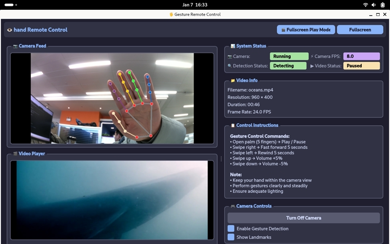

Run the program
Run the main.py startup script in the src directory. If the program starts successfully, a camera preview window will open.
cd demo-gesture-remote-control/src/
python3 main.py
Gesture Mapping
Ensure the camera faces the gesture interaction area under stable lighting conditions.
| Gesture | Function |
| Open palm (5 fingers) | Play / Pause |
| Finger slide right | Fast forward 5 seconds |
| Finger slide left | Rewind 5 seconds |
| Finger slide up | Volume +5% |
| Finger slide down | Volume -5% |

Application Demonstration
