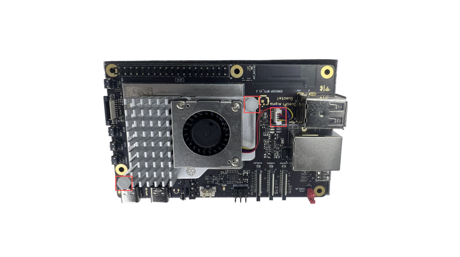

Fan Configuration
Run the following command to configure the fan speed:
sudo quecpi_config fan set speed <0-255>

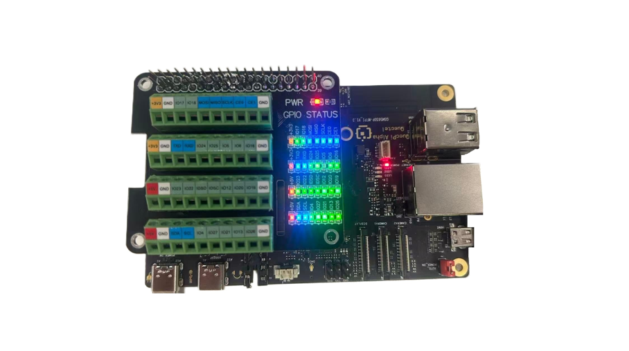

40-Pin Interface Operating Mode Configuration
First modify the configuration file /etc/quecpi_config/quecpi_config.ini, and then run the following command to apply the configuration:
sudo quecpi_config 40pin set
  • Note: The changes will take effect after the board is rebooted.

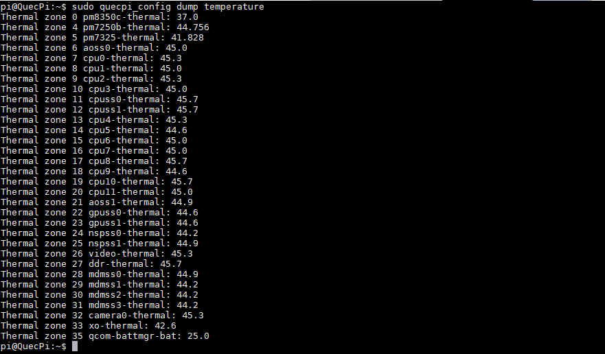

Query System Module Temperatures
Run the following command to query module temperatures:
sudo quecpi_config dump temperature

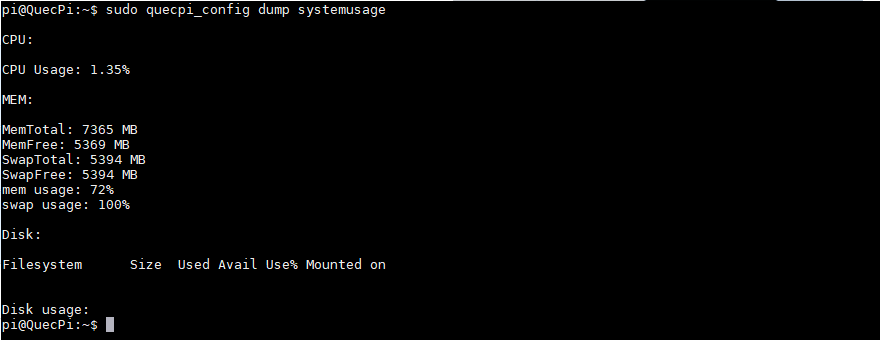

Query System CPU, Memory, and Storage Status
Run the following command to query system CPU, memory, and storage status:
sudo quecpi_config dump systemusage

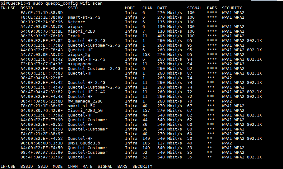

Configure Wi-Fi
Run the following command to scan for available Wi-Fi networks:
sudo quecpi_config wifi scan
Run the following command to view existing Wi-Fi connections:
sudo quecpi_config wifi show
Run the following command to check the Wi-Fi connection status:
sudo quecpi_config wifi dump <connection uuid>
Run the following command to add Wi-Fi connection:
sudo quecpi_config wifi connect <ssid> <password>
  • After successful connection, the corresponding wireless network status will be displayed as Connected, and the Wi-Fi connection icon will appear in the upper right corner.
