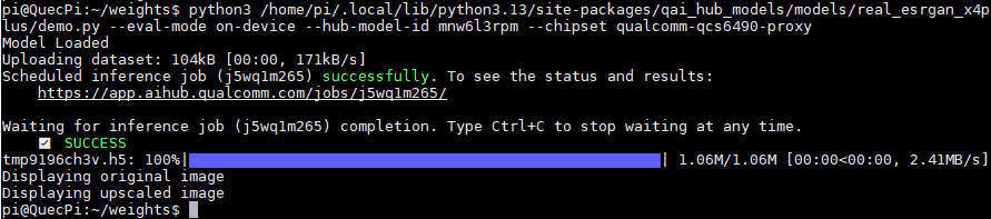

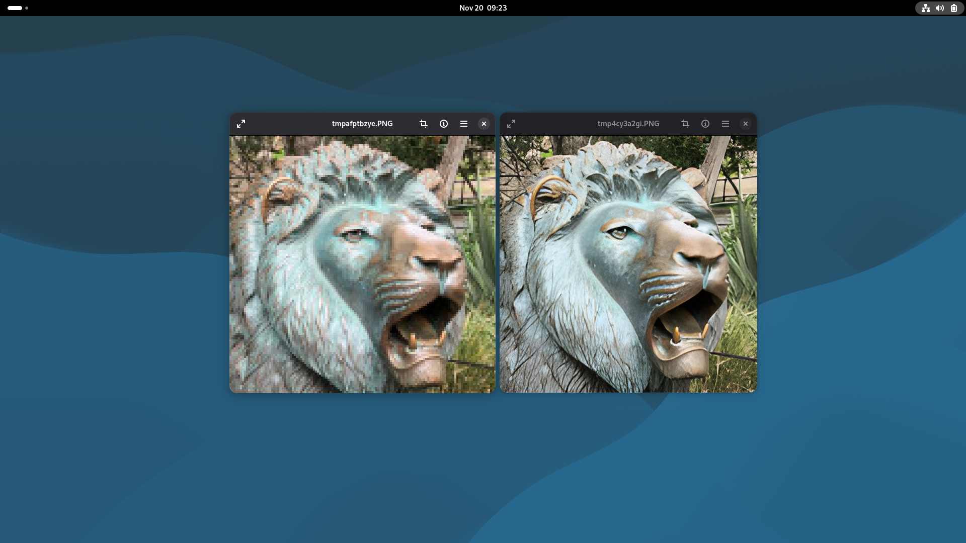

Run Demo
python3 -m qai_hub_models.models.real_esrgan_x4plus.demo --eval-mode on-device --hub-model-id <mode-id> --chipset ${PRODUCT_CHIP}
- Please modify the placeholder mode-id following the hub-model-id parameter with the mode-id generated by the command above.
