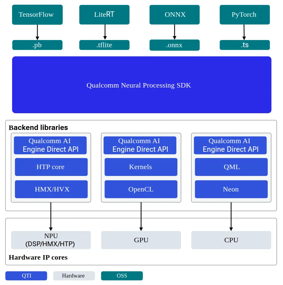

QAIRT
QAIRT (Qualcomm ® AI Runtime ) SDK is a software package that integrates Qualcomm ® AI software products, including Qualcomm ® AI Engine Direct、Qualcomm ® Neural Processing SDK and Qualcomm ® Genie. QAIRT provides developers with a complete set of tools for porting and deploying AI models on Qualcomm® hardware accelerators, as well as the runtime for executing models on CPU, GPU, and NPU.
Supported inference backends:
  • CPU
  • GPU
  • NPU

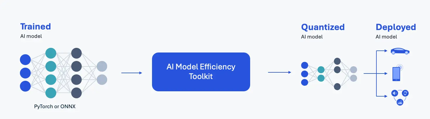

AIMET
AIMETAI Model Efficiency Toolkit)is a quantization tool for deep learning models such as PyTorch and ONNX. AIMET enhances model runtime performance by reducing computational load and memory footprint. With AIMET, developers can quickly iterate and find the optimal quantization configuration to achieve the best balance between accuracy and latency. Quantized models exported by AIMET can be compiled and deployed to the Qualcomm NPU via QAIRT, or executed directly using ONNX Runtime.

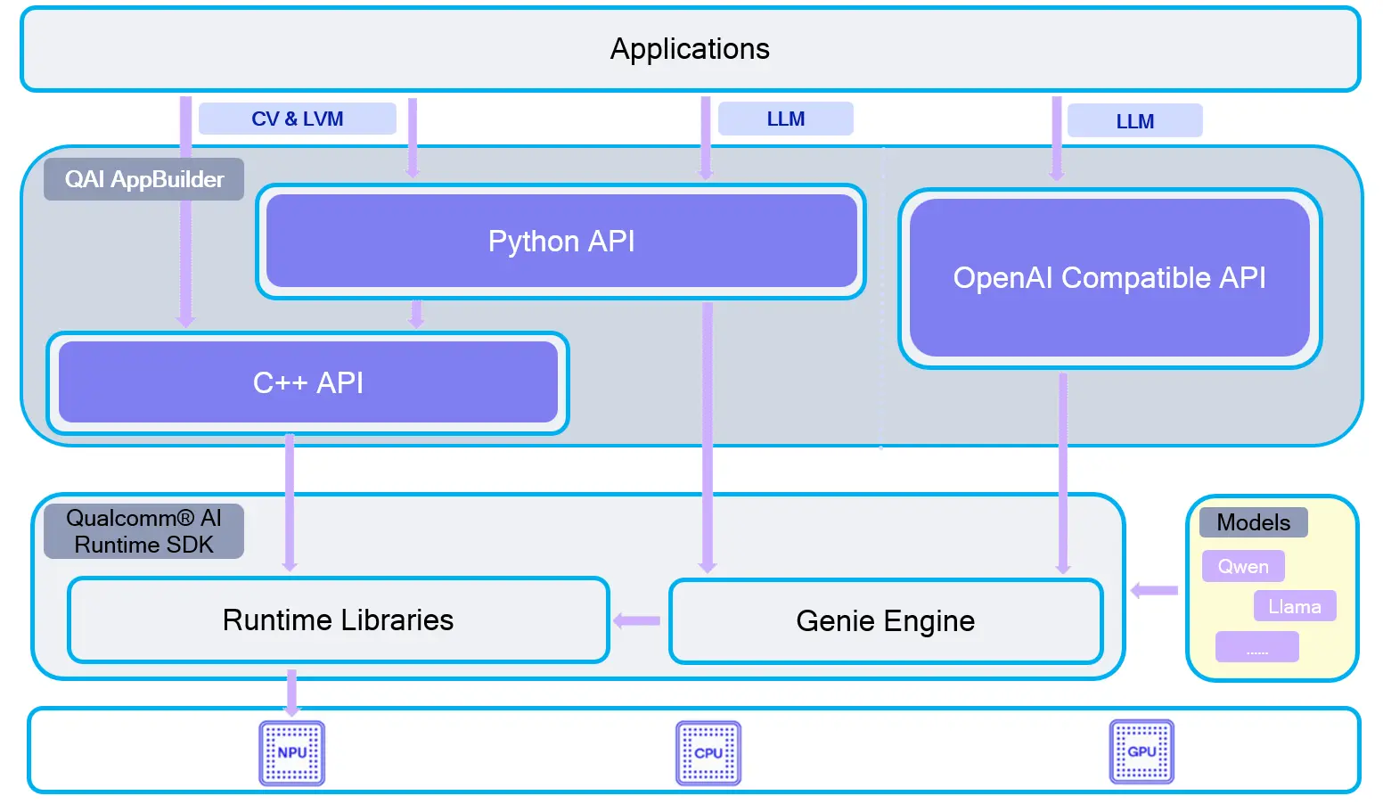

QAI-APPBUILDER
Quick AI Application Builder (QAI AppBuilder) assists developers in deploying AI models and designing AI applications on Qualcomm® SoC platforms equipped with the Qualcomm® Hexagon™ Processor (NPU) based on the Qualcomm® AI Runtime SDK. This tool encapsulates the model deployment APIs into a set of simplified interfaces for loading models onto the NPU and executing inference, significantly reducing the complexity of model deployment for developers. Additionally, QAI AppBuilder provides several Demos for reference, helping developers quickly build their own AI applications.
