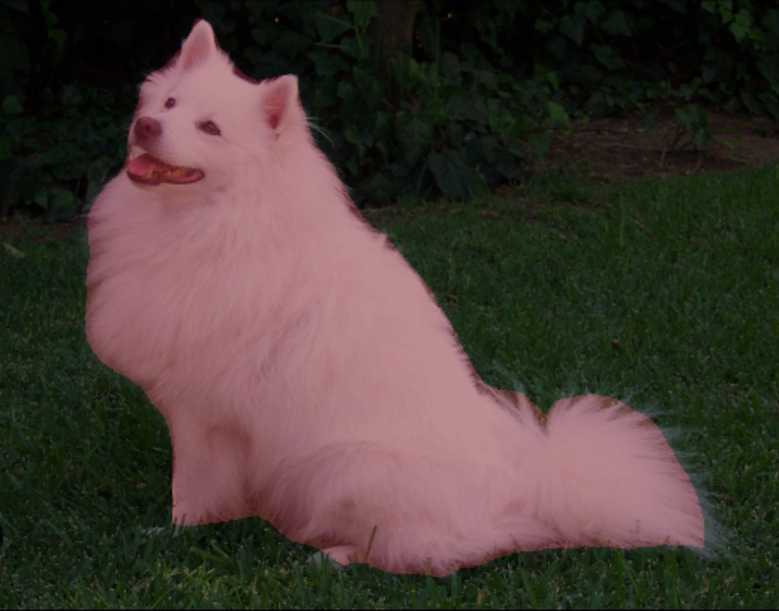

FCN-ResNet50 示例
cd ~/ai-engine-direct-helper/samples/linux/python
python3 fcn_resnet50/fcn_resnet50.py --image ./input.jpg
输入图像
输出图像

ConvNext-Tiny 示例
python3 convnext_tiny/convnext_tiny.py
输入图像
程序输出日志
$ python3 convnext_tiny/convnext_tiny.py
Current file directory: /mnt/ssd/qualcomm/701/zzf_fork/ai-engine-direct-helper/samples/linux/python/convnext_tiny
     0.0ms [WARNING]  <W> Initializing HtpProvider
/prj/qct/webtech_scratch20/mlg_user_admin/qaisw_source_repo/rel/qairt-2.37.1/point_release/SNPE_SRC/avante-tools/prebuilt/dsp/hexagon-sdk-5.4.0/ipc/fastrpc/rpcmem/src/rpcmem_android.c:38:dummy call to rpcmem_init, rpcmem APIs will be used from libxdsprpc
     0.0ms [WARNING]  <W> This META does not have Alloc2 Support
   132.1ms [WARNING] Time: Read model file to memory. 15.88
   176.1ms [WARNING] Time: contextCreateFromBinary. 44.01
   176.2ms [WARNING] Time: UnmapViewOfFile. 0.00
   176.6ms [WARNING] Time: model_initialize convnext_tiny 176.53
   245.2ms [WARNING] Time: model_inference convnext_tiny 11.95
Top 5 predictions for image:
Samoyed 0.637629509
Pomeranian 0.1382825226
keeshond 0.0217001885
Arctic fox 0.0138142202
white wolf 0.0115938596
/prj/qct/webtech_scratch20/mlg_user_admin/qaisw_source_repo/rel/qairt-2.37.1/point_release/SNPE_SRC/avante-tools/prebuilt/dsp/hexagon-sdk-5.4.0/ipc/fastrpc/rpcmem/src/rpcmem_android.c:42:dummy call to rpcmem_deinit, rpcmem APIs will be used from libxdsprpc
   263.1ms [WARNING] Time: model_destroy convnext_tiny 15.29
ConvNext-Base 示例
python3 convnext_base/convnext_base.py
输入图像
程序输出日志
$ python3 convnext_base/convnext_base.py
Current file directory: /mnt/ssd/qualcomm/701/zzf_fork/ai-engine-direct-helper/samples/linux/python/convnext_base
   193.9ms [WARNING] Time: Read model file to memory. 71.69
   269.5ms [WARNING] Time: contextCreateFromBinary. 75.47
   269.5ms [WARNING] Time: UnmapViewOfFile. 0.00
   270.9ms [WARNING] Time: model_initialize convnext_base 270.85
   348.3ms [WARNING] Time: model_inference convnext_base 30.17
Samoyed 0.8726790547
Pomeranian 0.0192712061
keeshond 0.0150661934
Japanese spaniel 0.0032834315
Eskimo dog 0.0020474677
   365.5ms [WARNING] Time: model_destroy convnext_base 14.44
