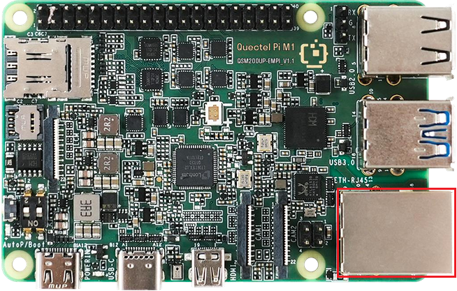

The Quectel Pi M1 smart single-board computer comes with one standard RJ45 interface, supporting Ethernet communication rates of 10/100/1000 Mbps.
Ethernet cable requirements: Only straight-through cables are supported; crossover cables are not supported.
Hardware interface:

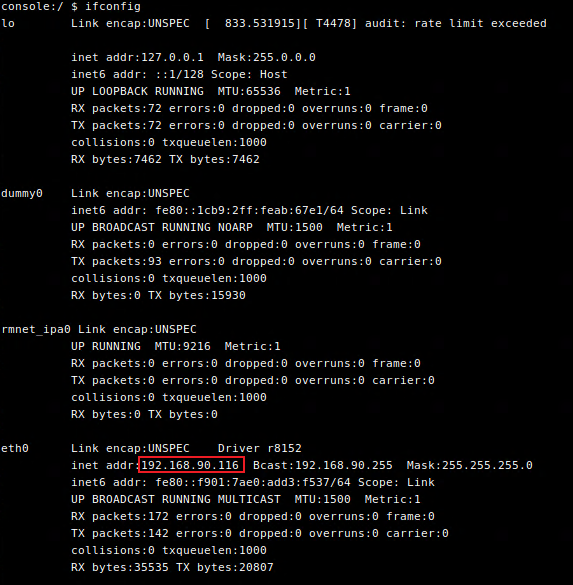

By default, DHCP is enabled on the system to automatically obtain network configurations.
  1. Use the ifconfig command in the terminal to view the network interface addresses:
    ifconfig
    Output example: The 192.168.90.116 after inet addr: is the the local IP address.
