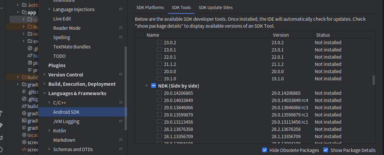

NDK configuration (for low-level hardware API calls)
  • Open Android Studio, go to File > Settings > Appearance & Behavior > System Settings > Android SDK, and switch to the SDK Tools tab.
  • Tick Show Package Details, NDK (Side by side) and CMake, select the corresponding version and click "Apply" to complete the download and installation.
    Android Studio NDK configuration guide

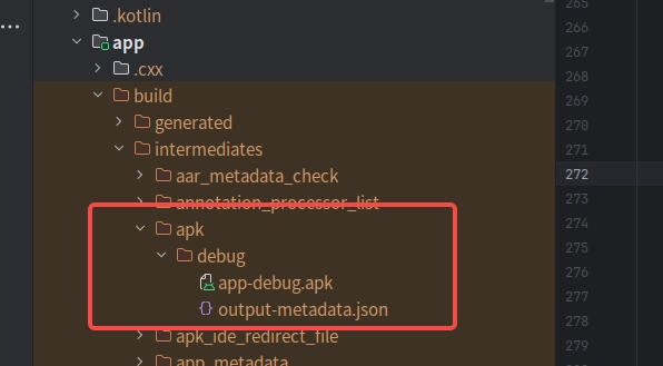

  • Click the green run button in the Android Studio toolbar, and the IDE will automatically execute predefined build scripts to help us complete the compilation, packaging, and installation of the debug version of the APK. The premise is a simulator or real device must be currently connected; otherwise, a "No devices available" prompt will appear. The generated APK file is located at project file path/app/build/intermediates/apk/debug/app-debug.apk.
    APP debugging guide
  • If no emulator is connected and you want to manually generate a debug version or a signed release version APK, you can select "Android App Bundle" or "APK" in the top toolbar of Android Studio under Build - Generate Signed App Bundle or Apk path. After clicking "Next", you will be prompted to select a signature file. You can choose an existing .jks or .keystore file or create a new signature file. When creating a new one, name the signature file (default suffix is .jks) and select the storage path.
    APP debugging guide

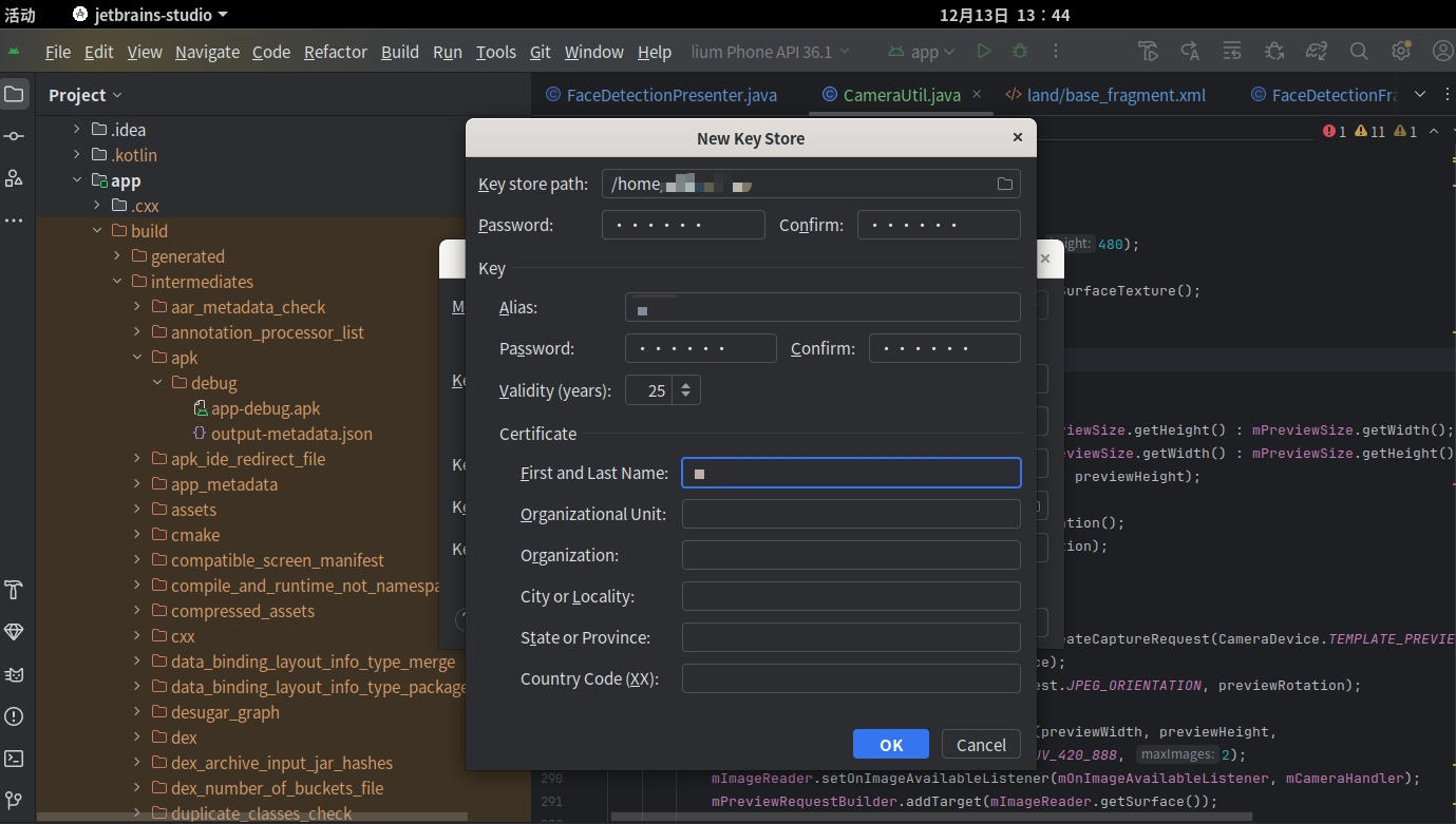

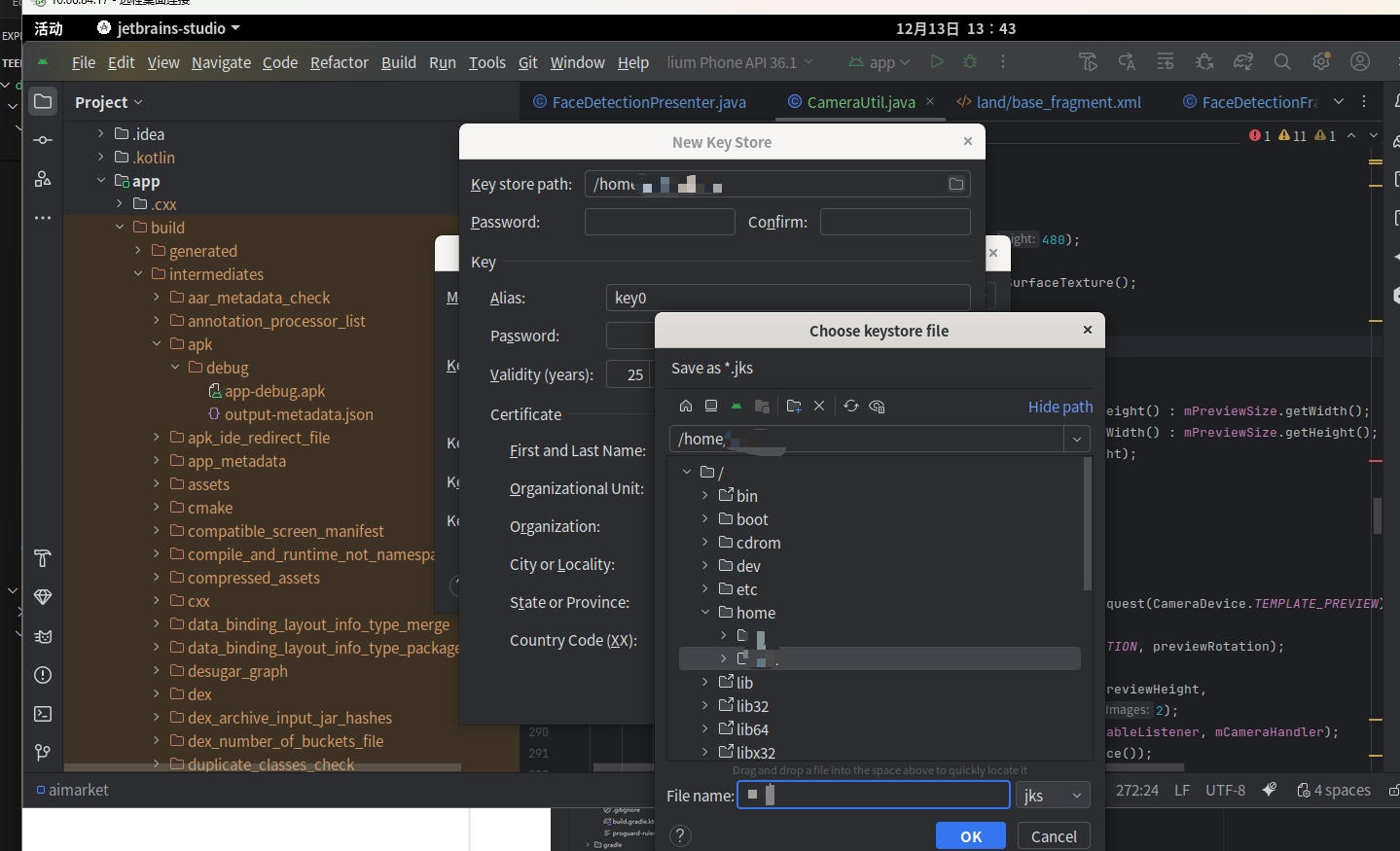

Then set your signature password and key alias("Alias", the custom identifier for the key, which can be named by yourself). Click "OK" and the system will automatically create the signature file.
APP debugging guide
  • After completing the signature configuration, select the release or debug package. The system will use the currently configured signature file for packaging. The generated signed APK file is located in the project file path/app/release directory by default.

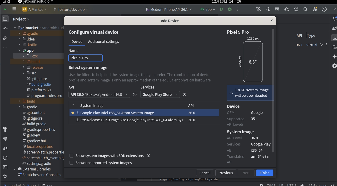

Generally, when starting a project for the first time, Android Studio will create an emulator by default, so you can directly click the run button to start the project. If you need to use a simulator with a specified version or resolution, you need to create one manually.

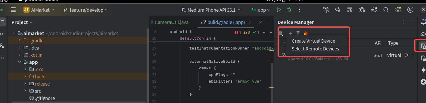

  • Find "Device Manager" in the Android Studio toolbar, click "Create Virtual Device", select the emulator configuration you need, and click "Next".
    Emulator configuration guide

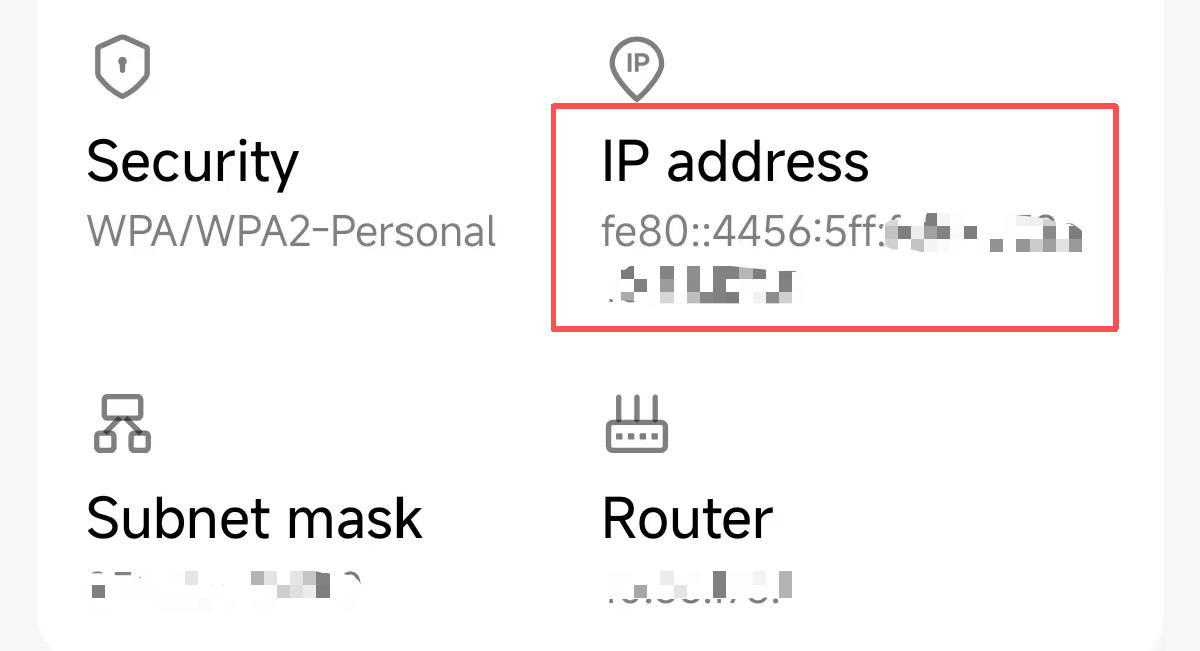

Wireless connection allows you to get rid of the constraints of cables, but usually requires USB to complete the initial setup first. Specific operations vary depending on the Android version of the phone.
  • Please ensure that the phone and computer are on the same local network, and that the phone has developer mode, USB debugging, and wireless debugging enabled.
  • Check the current IP address of the phone, enter the command "adb connect " in the terminal, if the information of the currently connected device appears, it means the connection is successful.
