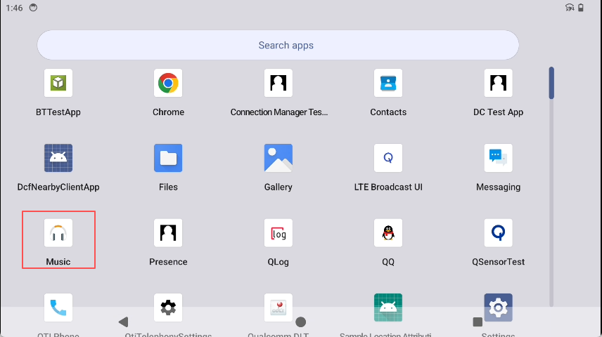

  1. Open the music player.

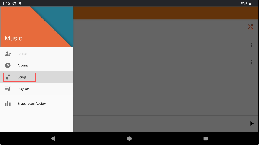

  1. Click the left option bar to find songs.

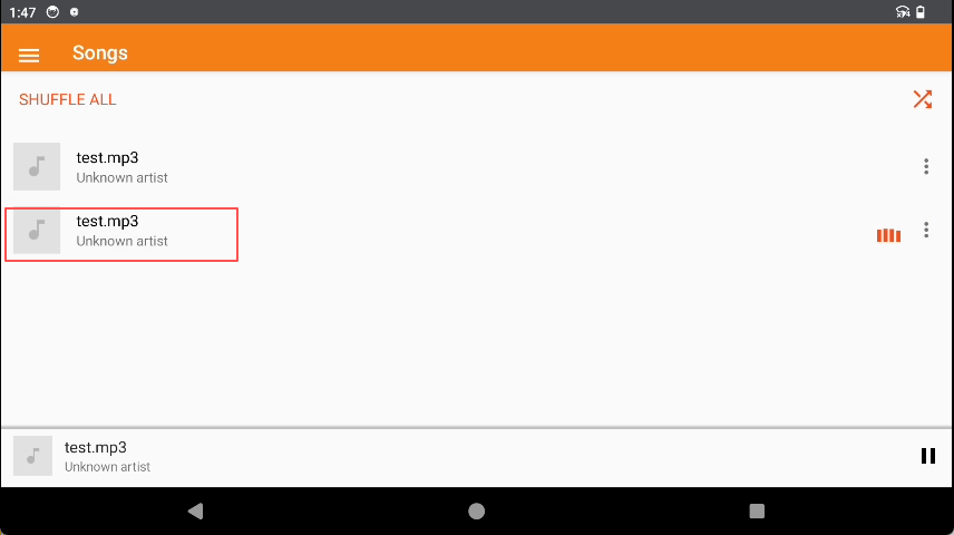

  1. Find the audio file and click it to play.

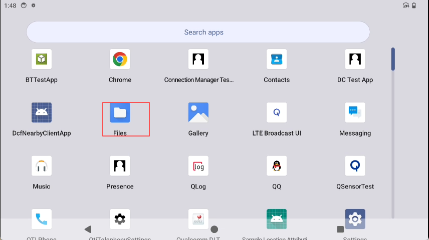

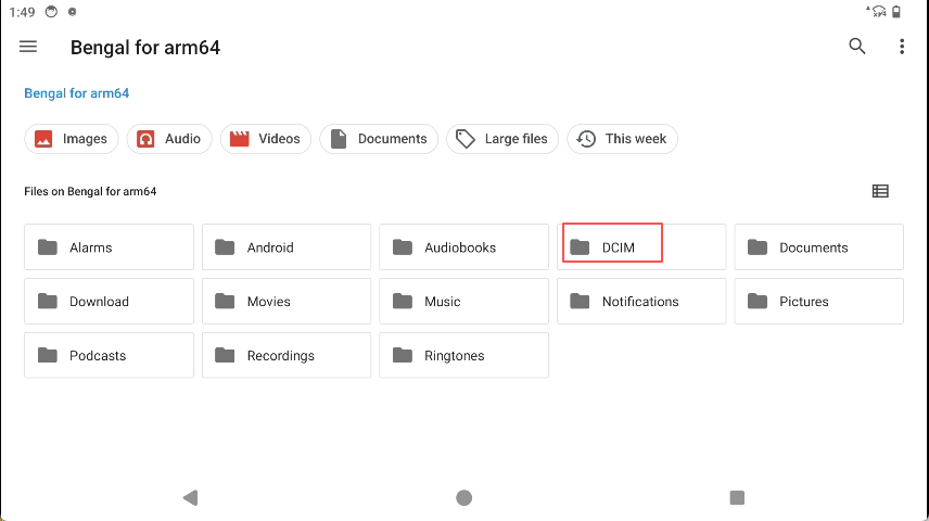

  1. Click the corresponding icons in sequence to enter the file manager.

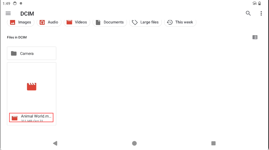

  1. Find the video file and double-click to play it.
