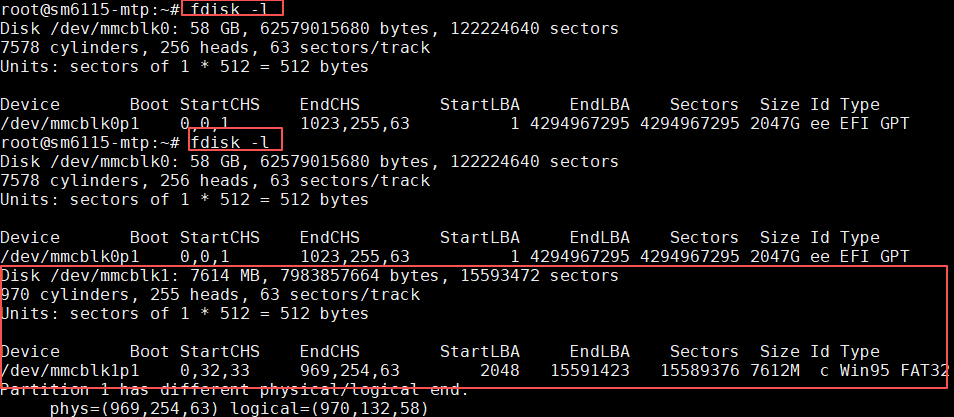

After inserting the SD card, you can use the following command to confirm whether the system recognizes the device:
fdisk -l
By comparing the output before and after insertion, you can confirm that the system has successfully recognized the SD card:

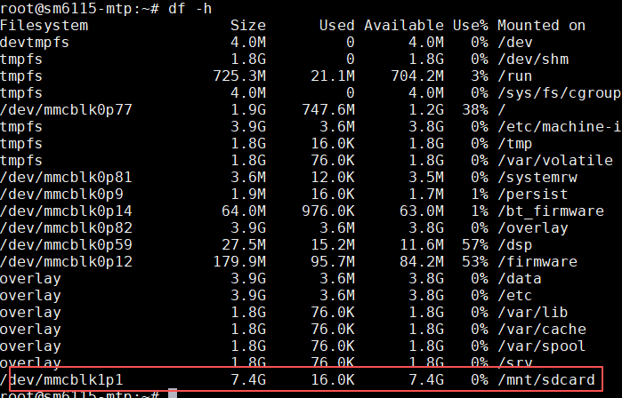

View the mount path:
df -h
As shown below, the device is automatically mounted to /mnt/sdcard:
