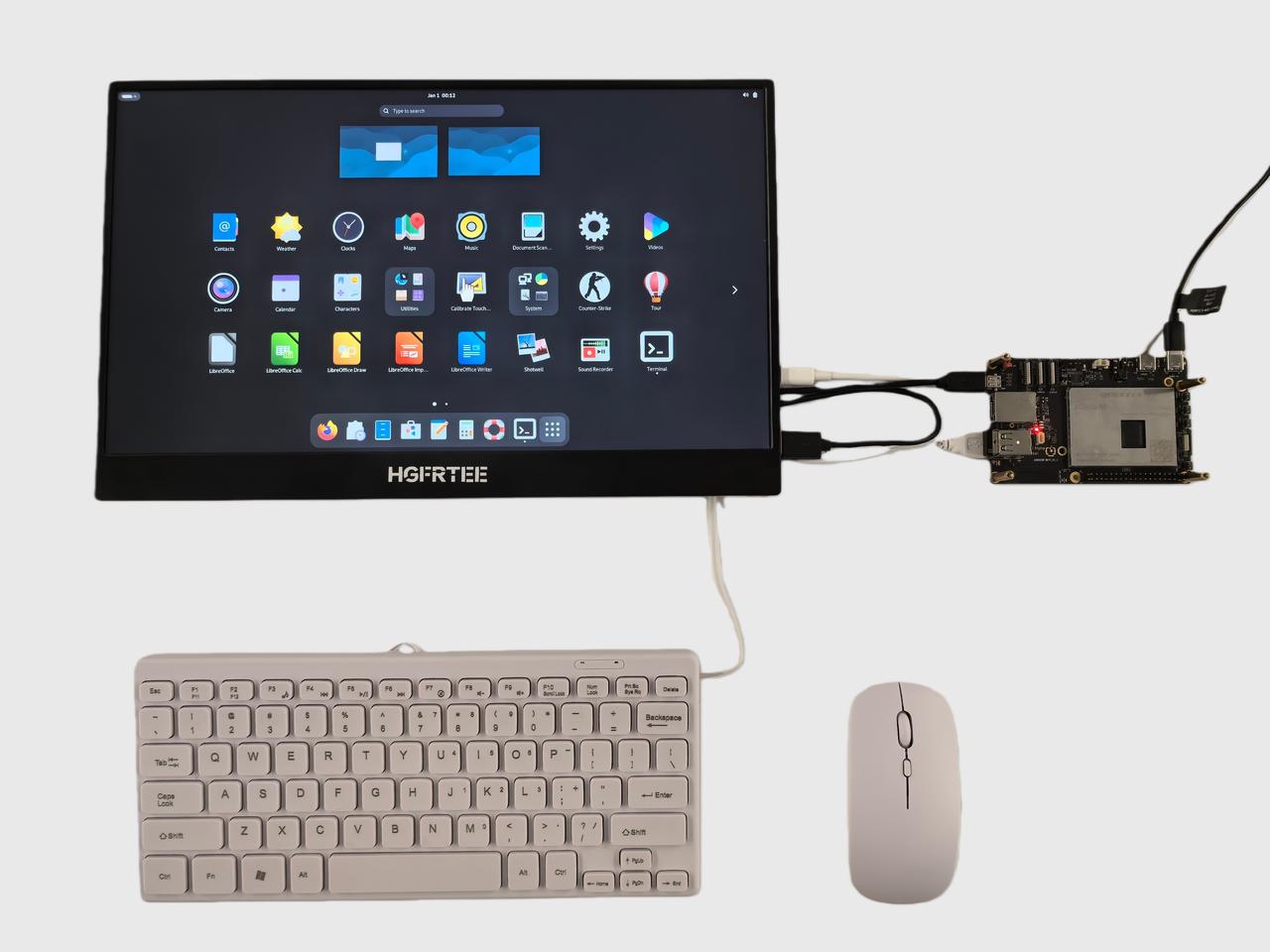

Display Connection:
Option 1 (High Definition): Connect one end of the USB-C DP display cable to the USB&DP interface of the single-board computer, and the other end to the USB-C interface of the monitor;
Option 2 (Compatibility): Connect one end of the HDMI cable to the HDMI interface of the single-board computer, and the other end to the HDMI interface of the monitor.

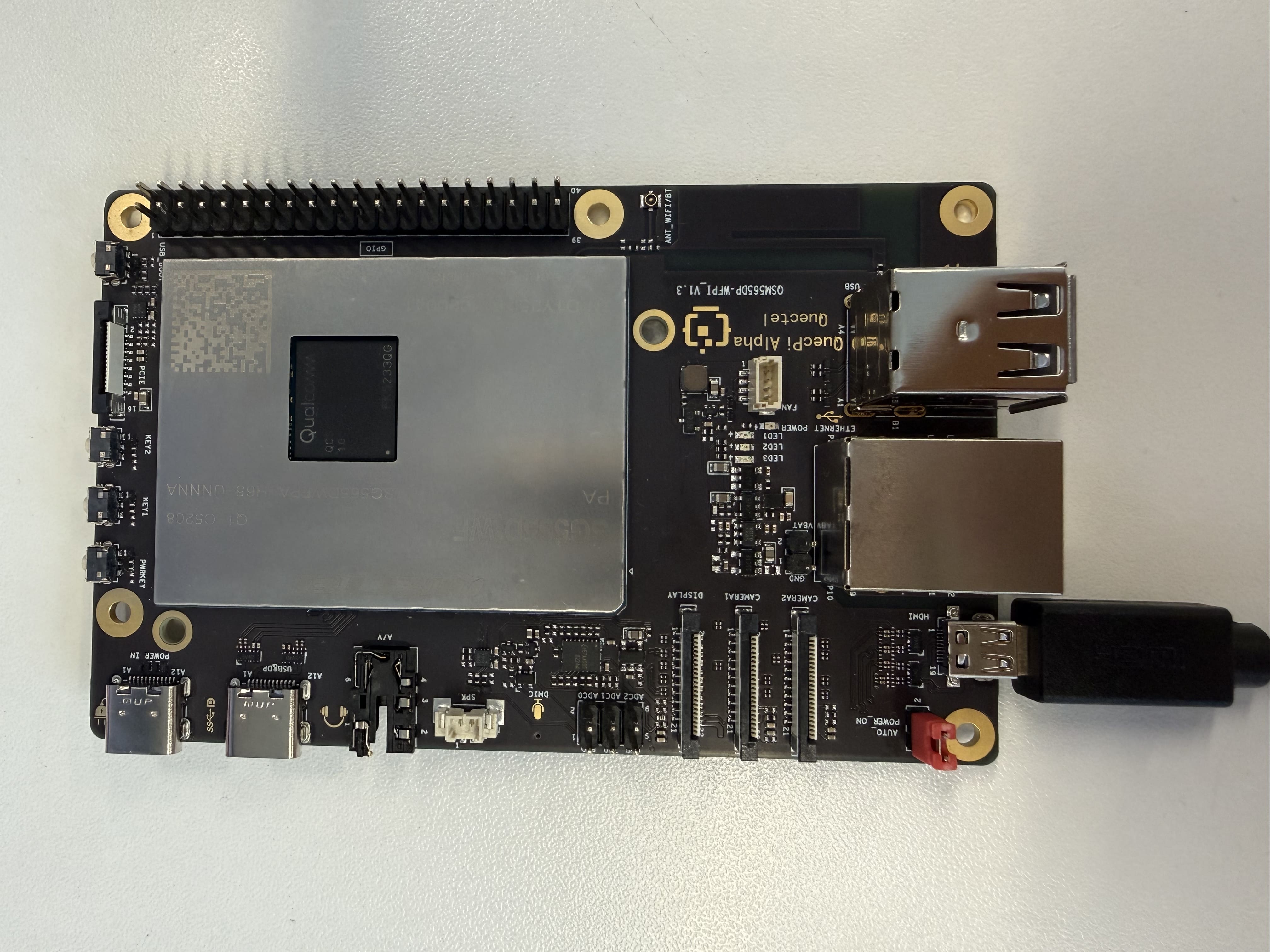

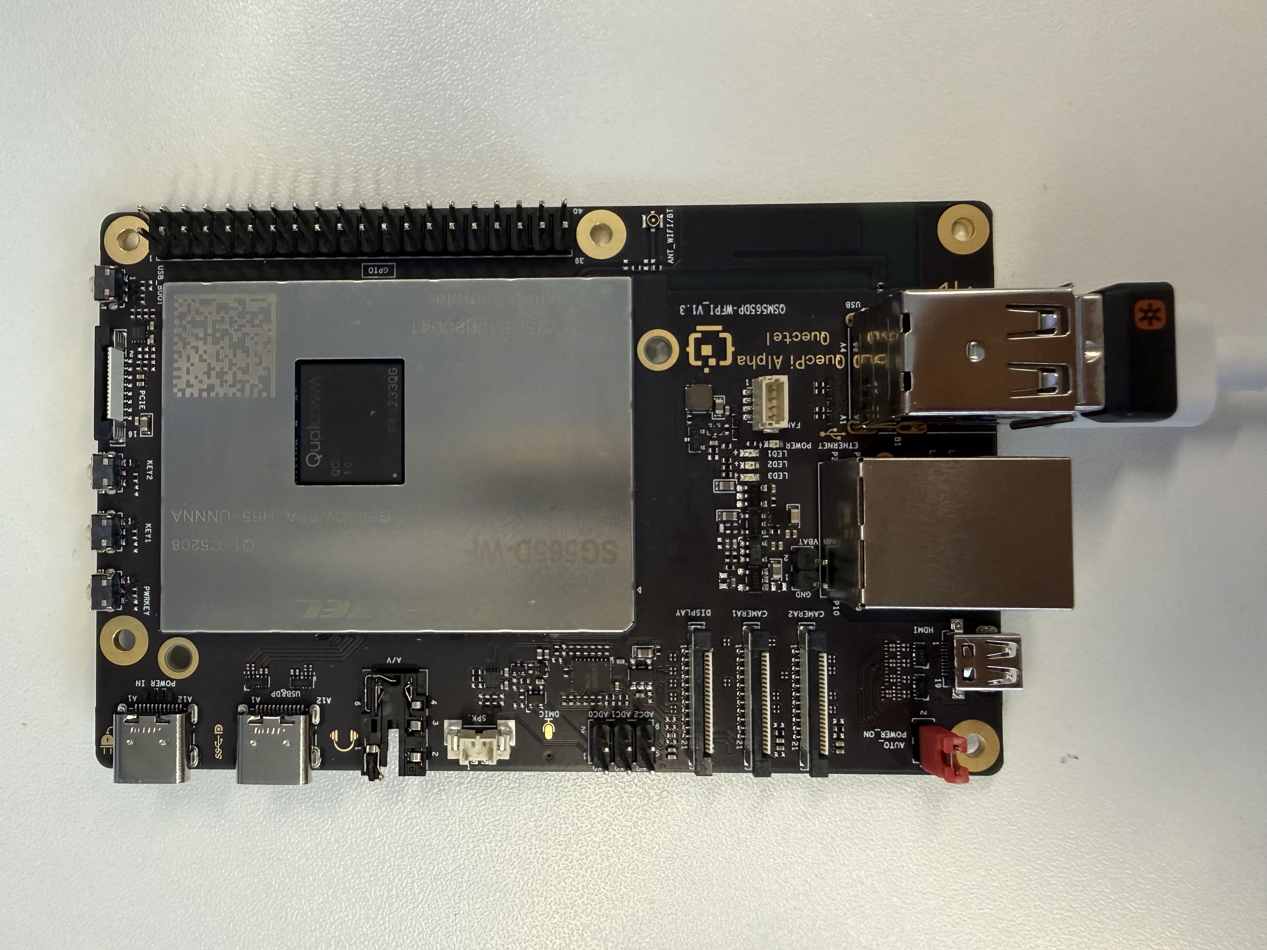

Peripheral Connection: Connect the USB keyboard and mouse to the two USB-A interfaces of the single-board computer; for wireless keyboard and mouse, insert the receiver into the USB port.

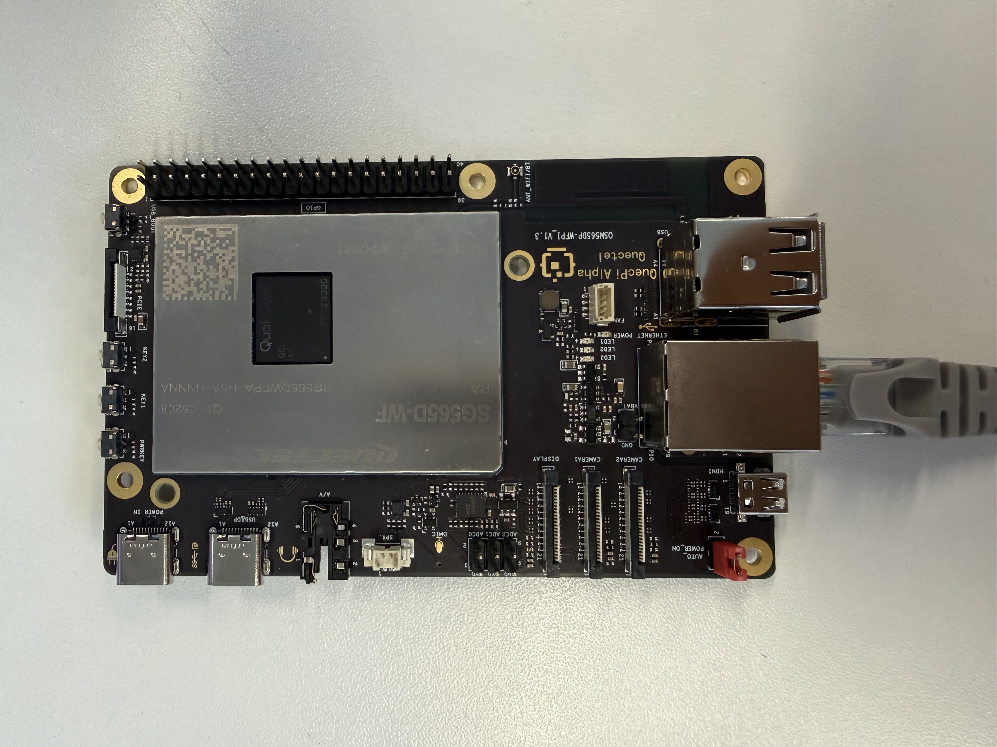

Network Connection: Connect the network port of the single-board computer to the LAN port of the router using a network cable.

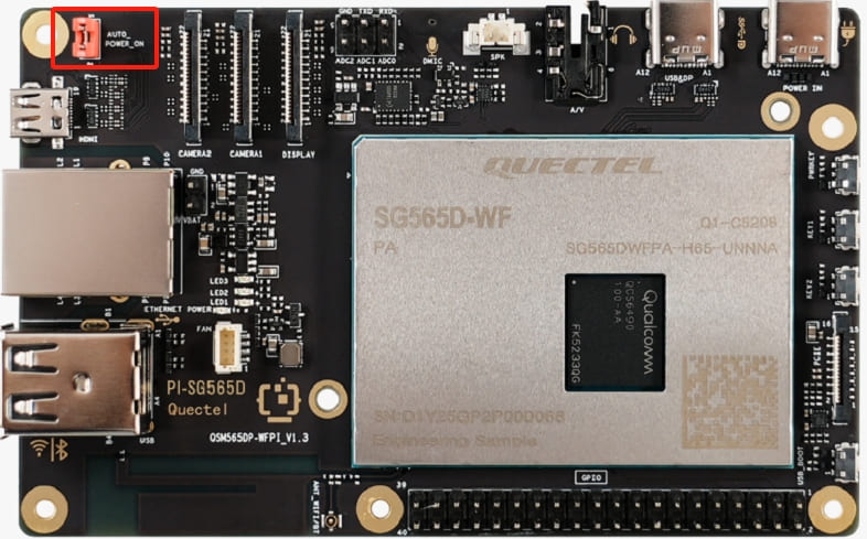

Jumper Cap Connection: Ensure that the pin header marked with
AUTO_POWER_ONin the upper left corner of the single-board computer is shorted with a jumper cap.

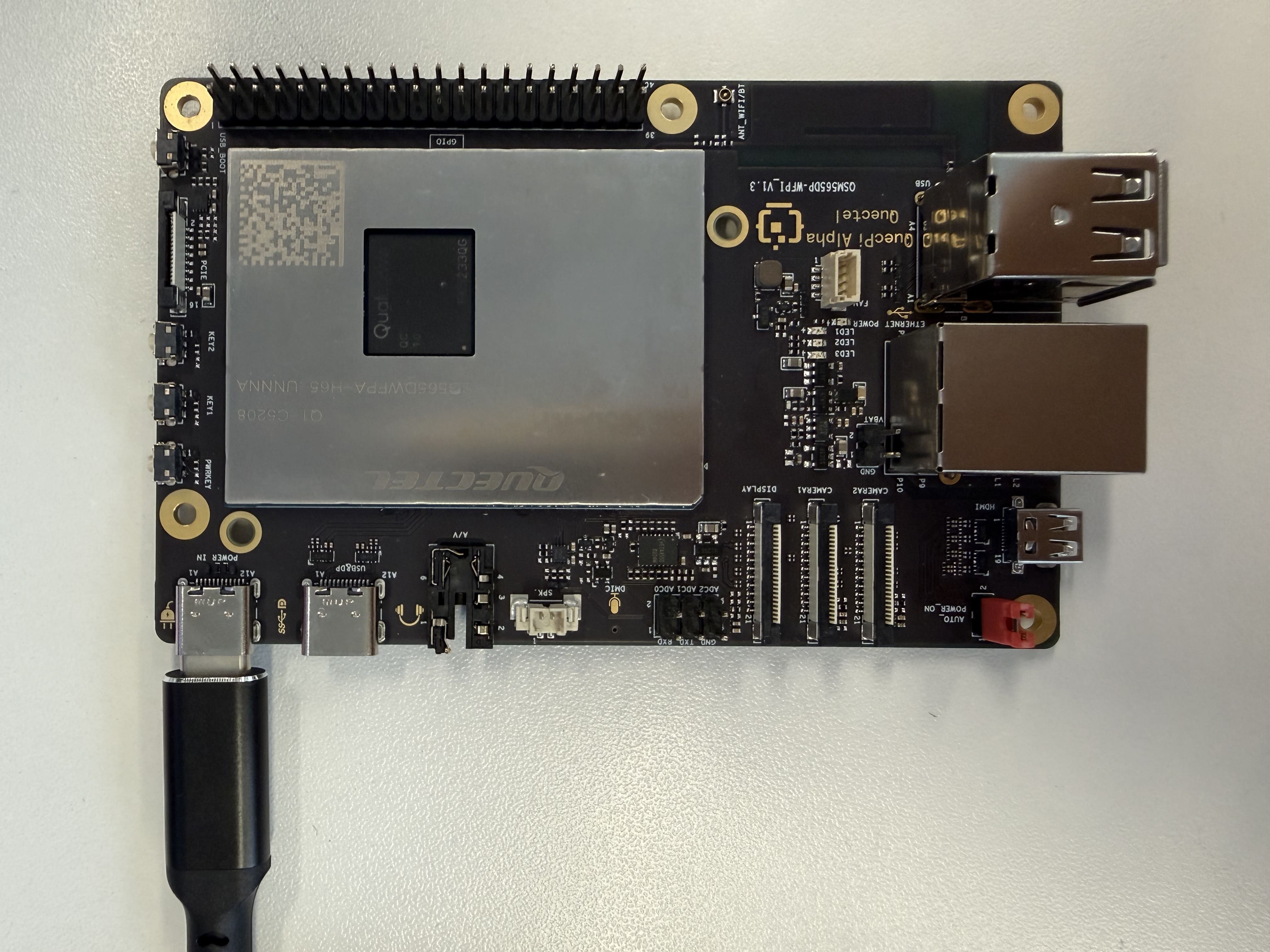

Power Supply Connection: Finally, connect the USB-A end of the USB-A power cable to the power adapter, and the USB-C end to the power port of the single-board computer (usually marked
POWER IN).
