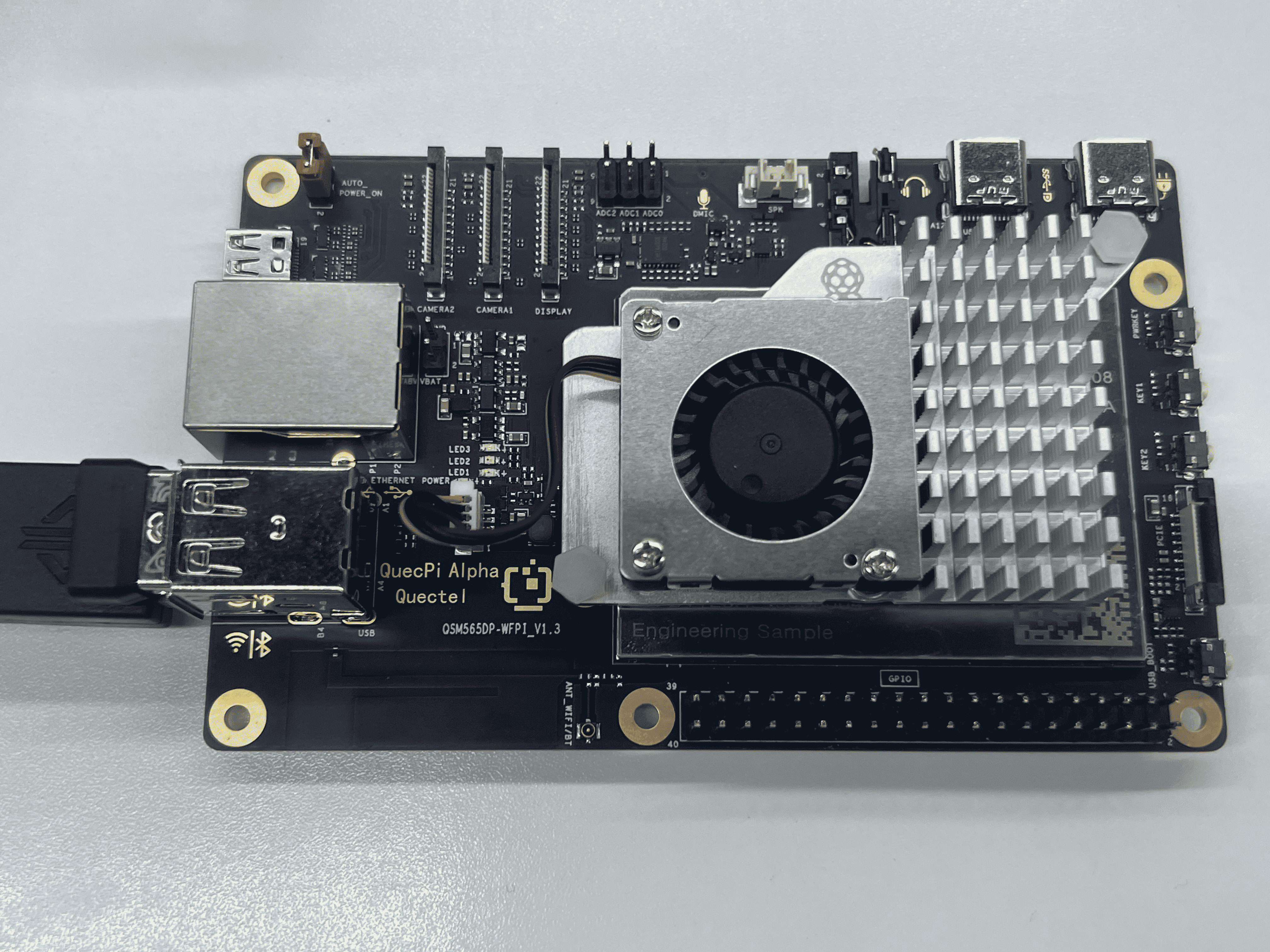

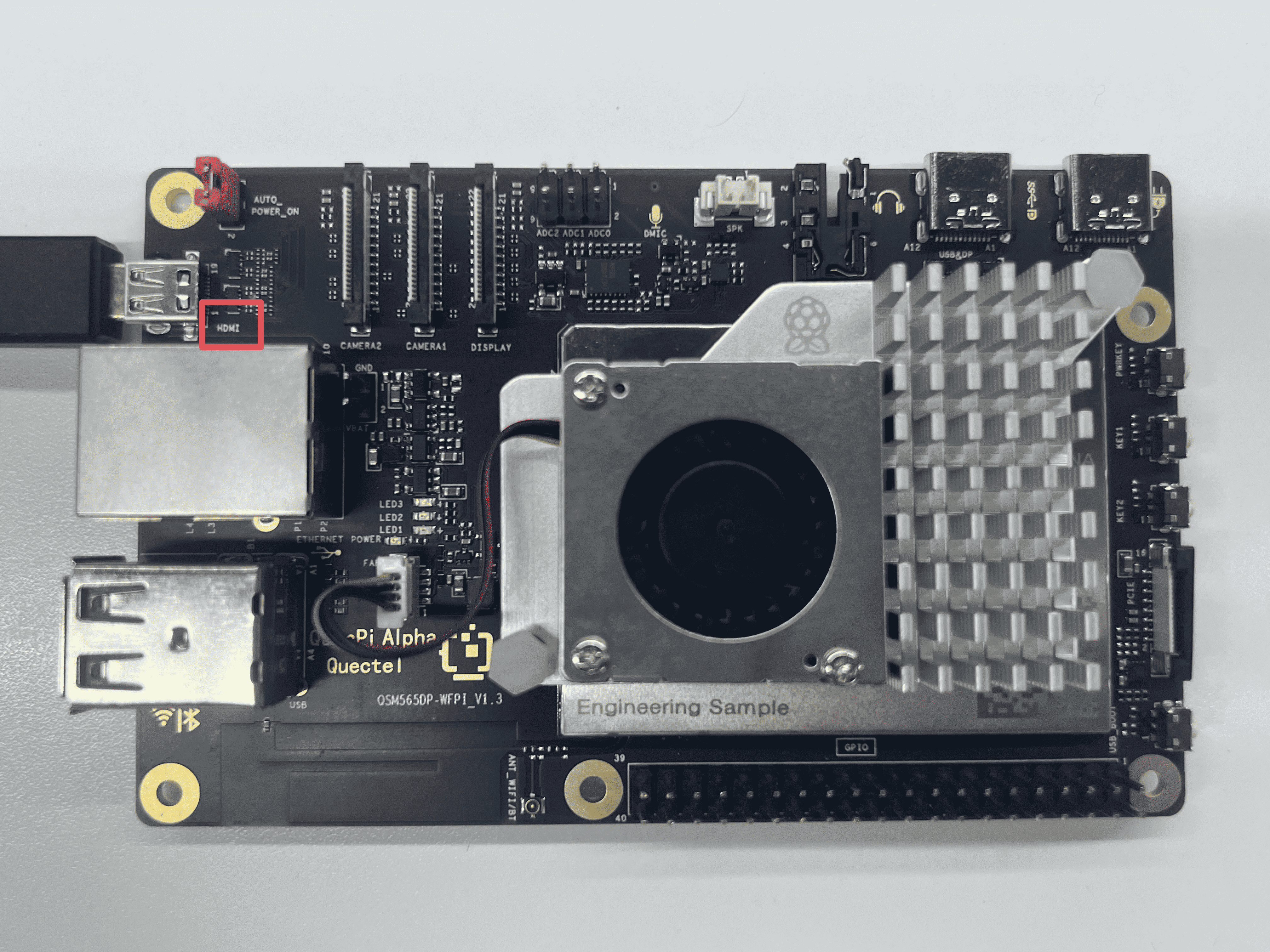

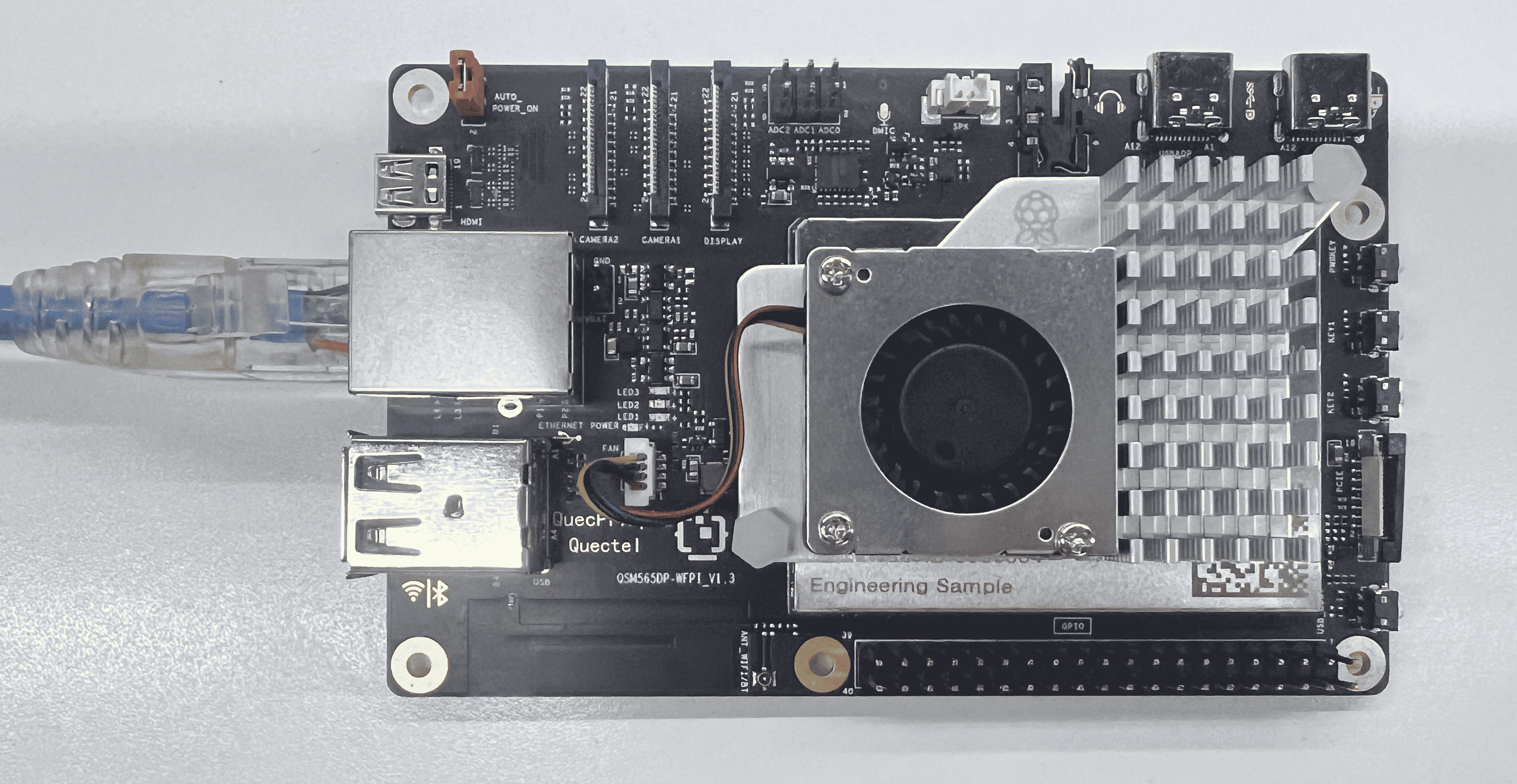

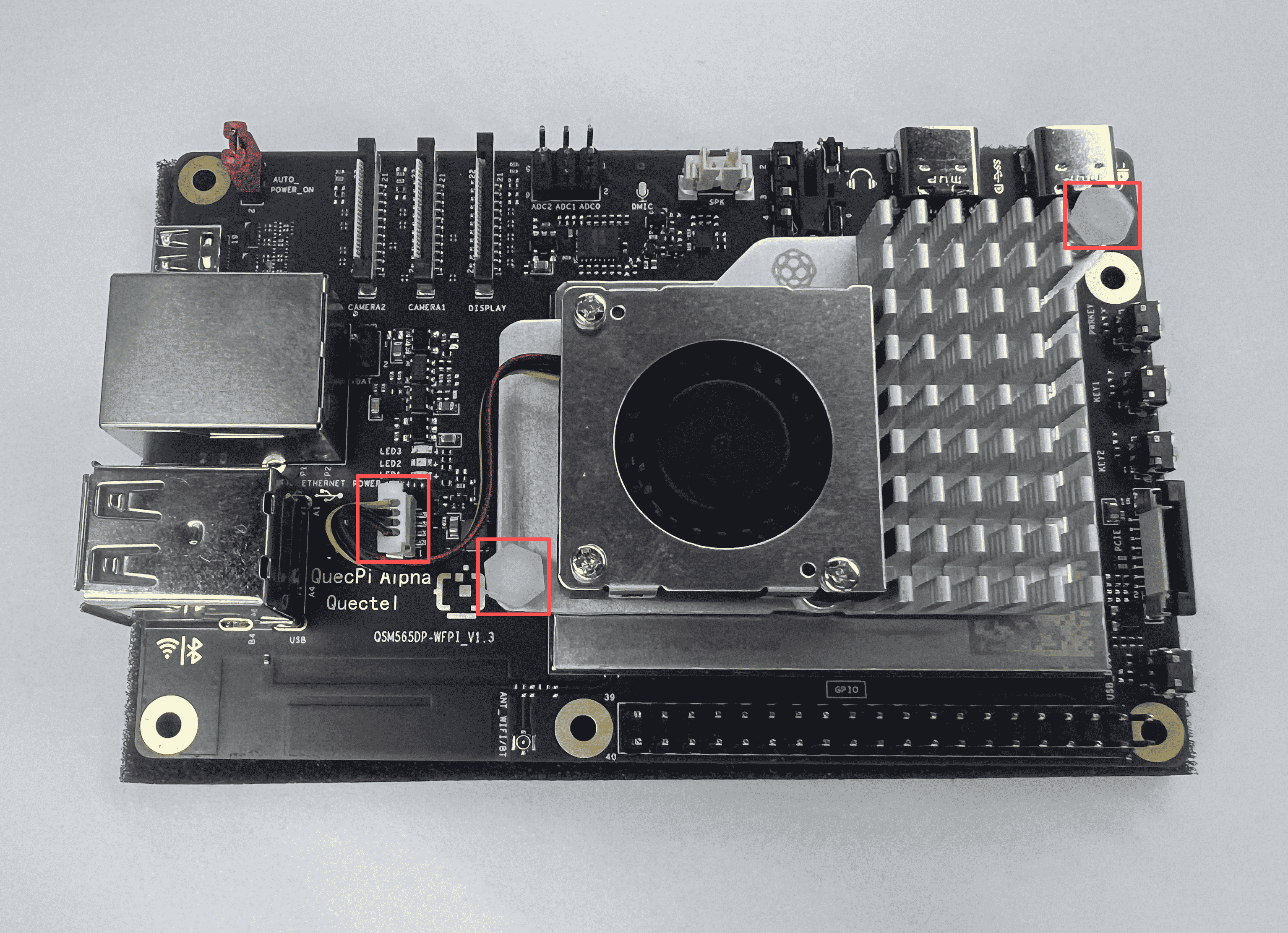

  • Install CPU Cooling Fan: Plug the fan cable into the FAN header on the board, then secure the heatsink clips into the mounting holes as shown:

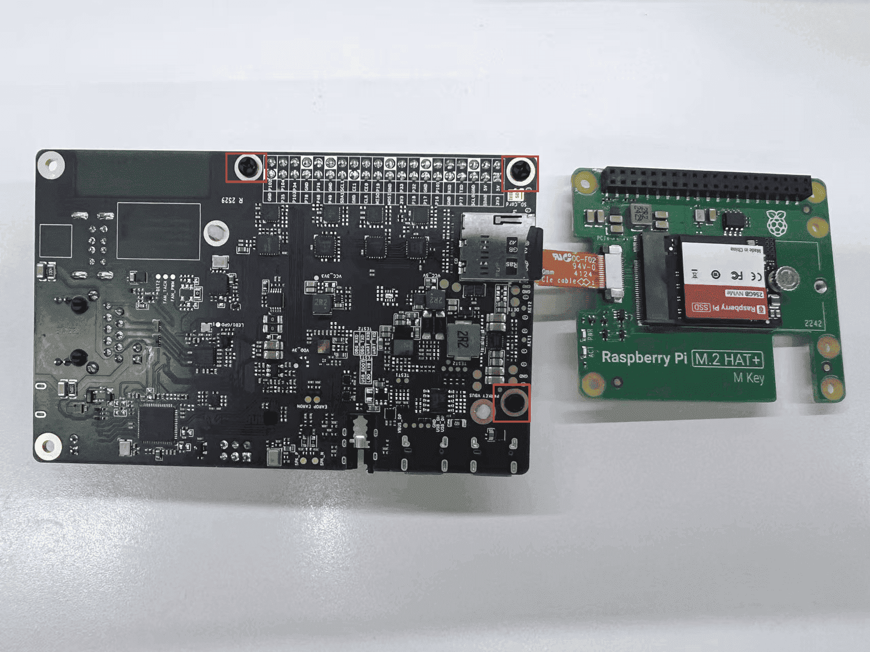

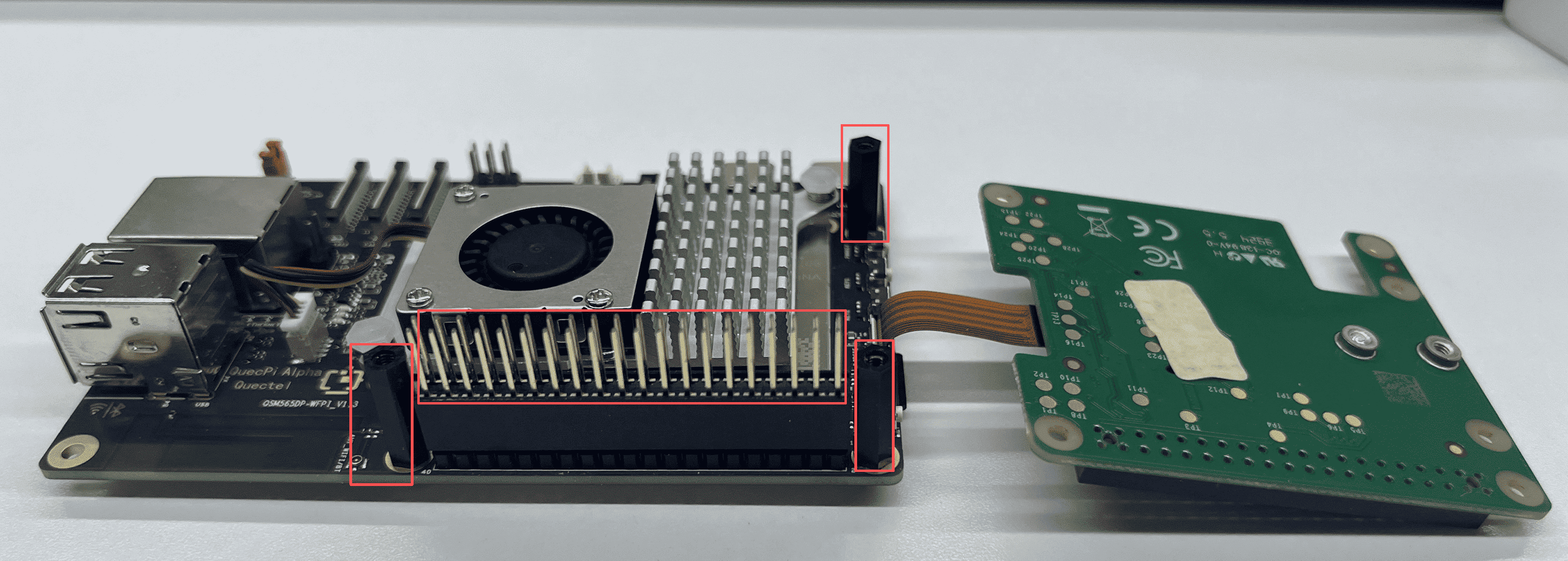

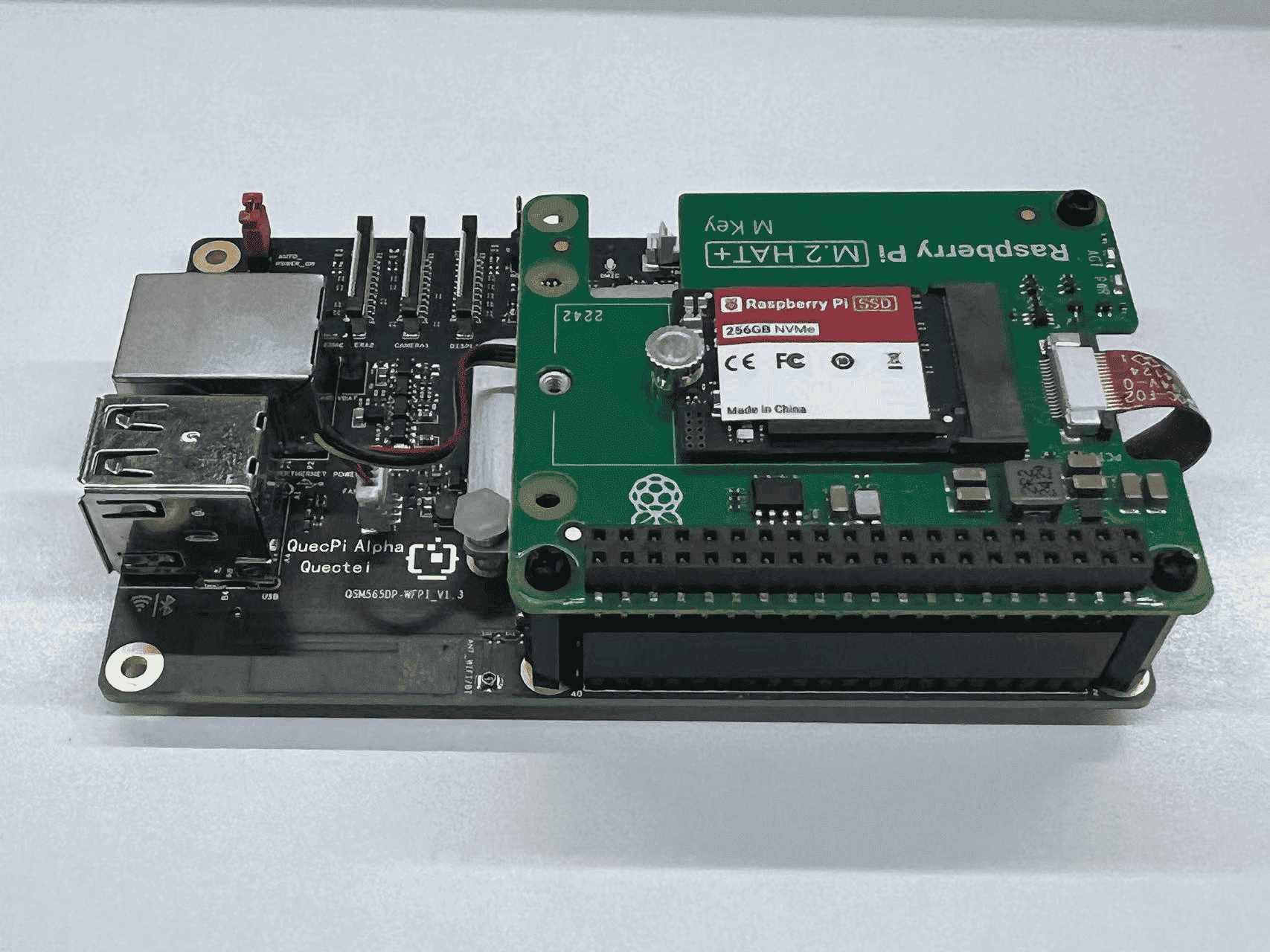

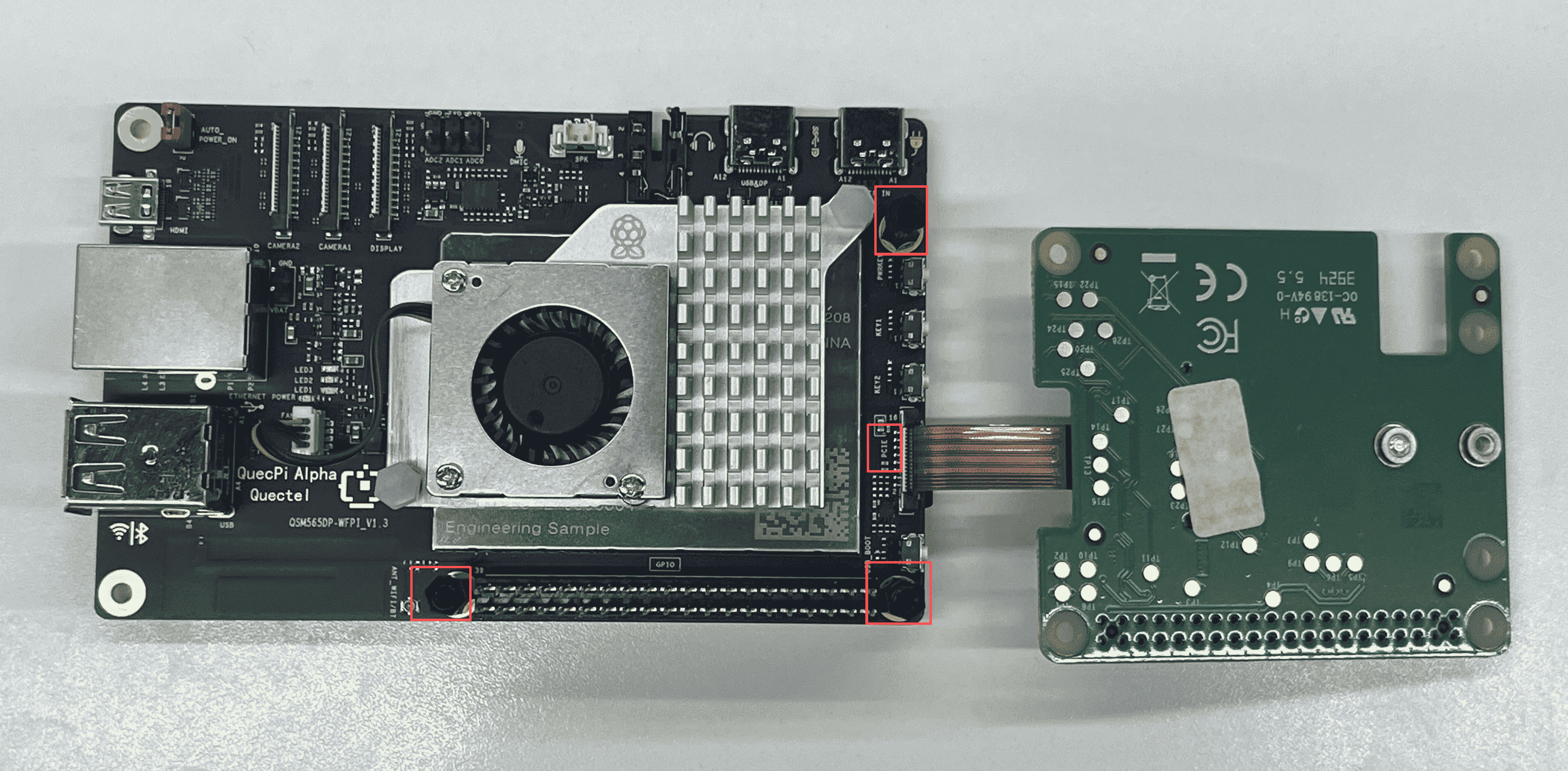

  • Install SSD:
    1. Install 3 nylon standoffs using short screws.
    2. Attach the GPIO adapter firmly.
    3. Insert the PCIe ribbon cable into the board’s PCIe slot and secure both sides.
    4. Place the M.2 HAT+ on top and secure it with 3 long screws.
Front view after installation:

Side view:
image-20251017155047092

  • Display Connection:Connect one end of the HDMI cable to the HDMI port of the single-board computer and the other end to the HDMI port of the monitor.
image-20251017144027933

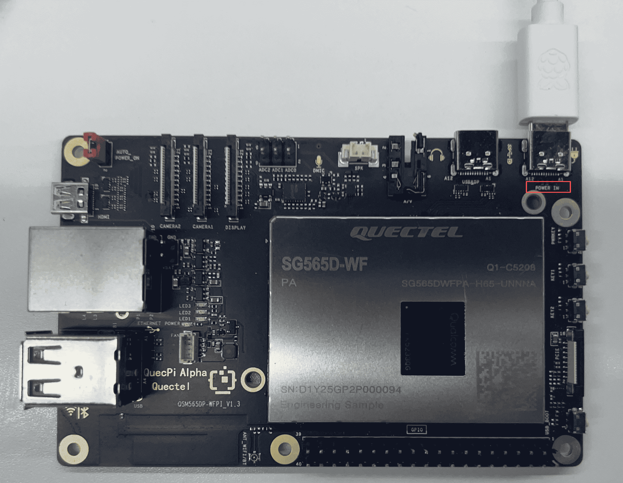

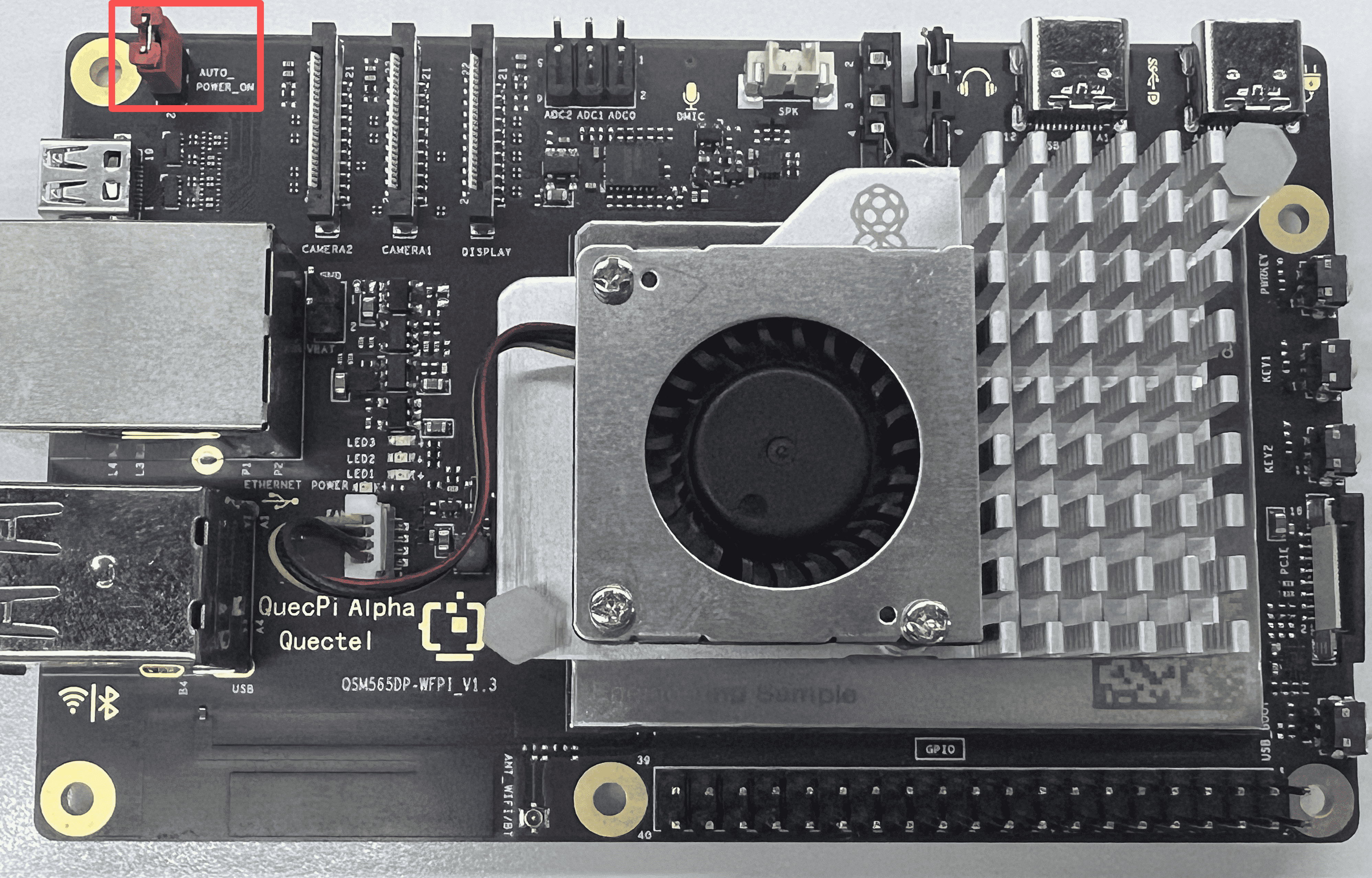

  • Jumper: Ensure the AUTO_POWER_ON pins are shorted with a jumper cap.
image-20251017144330473
  • Power: Connect USB-A power adapter to the POWER IN port.
image-20251017172353513

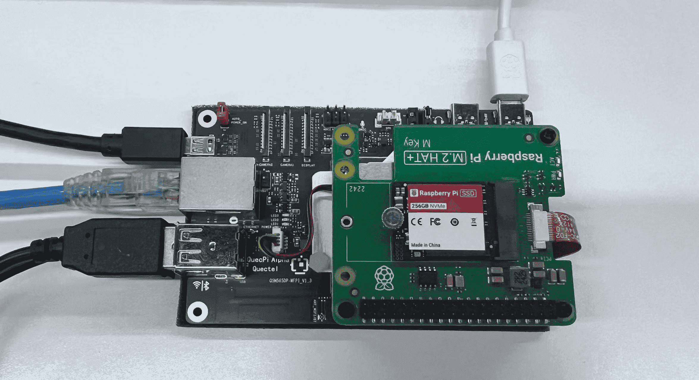

  • Final setup reference:
image-20251017171408602

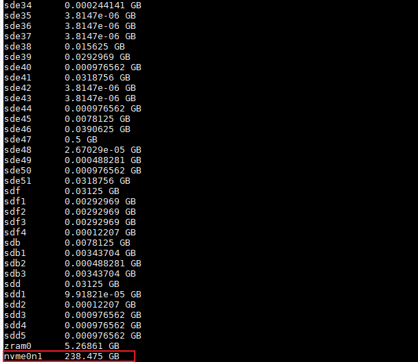

  • Check disk info
1.List partitions
awk 'NR > 2 {printf "%-10s %s\n", $4, $3 / 1024 / 1024 " GB"}' /proc/partitions

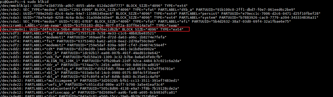

2.Check filesystem type(Note: The Quectel Pi H1 board is mounted with ext4 by default, If the file type of the external storage device does not match the system, the storage device needs to be reformatted.)
sudo blkid

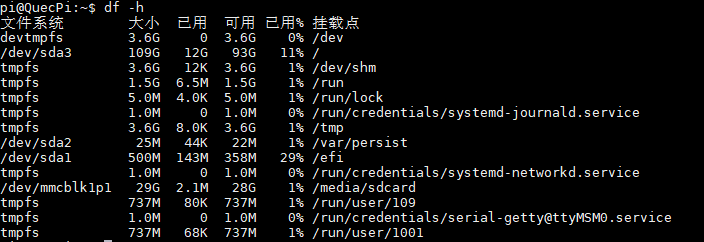

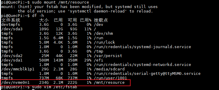

3.Check current mounts(If there is a mount point under /mnt/resource, you need to uninstall the mount point first)
df -h
image-20251016172803110

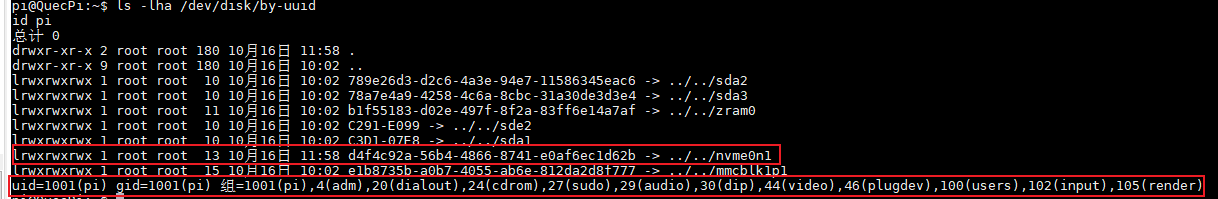

4.Get UUID and user UID/GID
ls -lha /dev/disk/by-uuid
id username
image-20251016200316142

  • Mount the drive
sudo mount /mnt/resource
image-20251016201719605

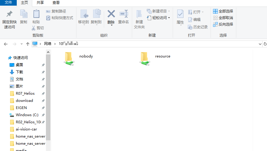

  • Get NAS IP.
  • In Windows Explorer, input"\\ <NAS_IP>",You’ll see shared folders.
image-20251018113321801
  • Open resource to add/delete/edit files.

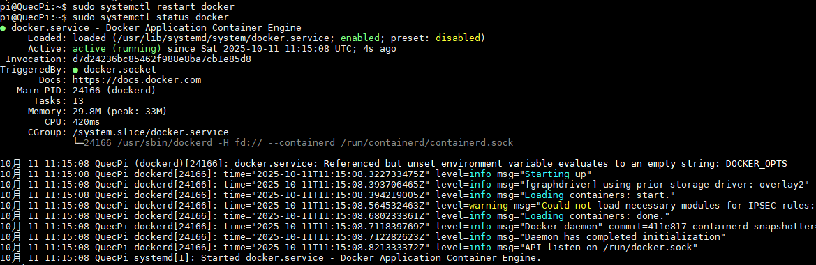

  • Check Docker service status
sudo systemctl status docker
After successful startup, the following is shown:

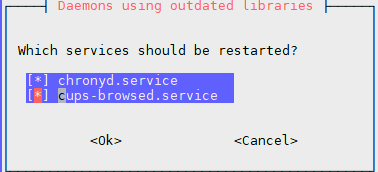

  • Full installation of wget
sudo apt install wget -y
When the following option box appears, just press Enter.

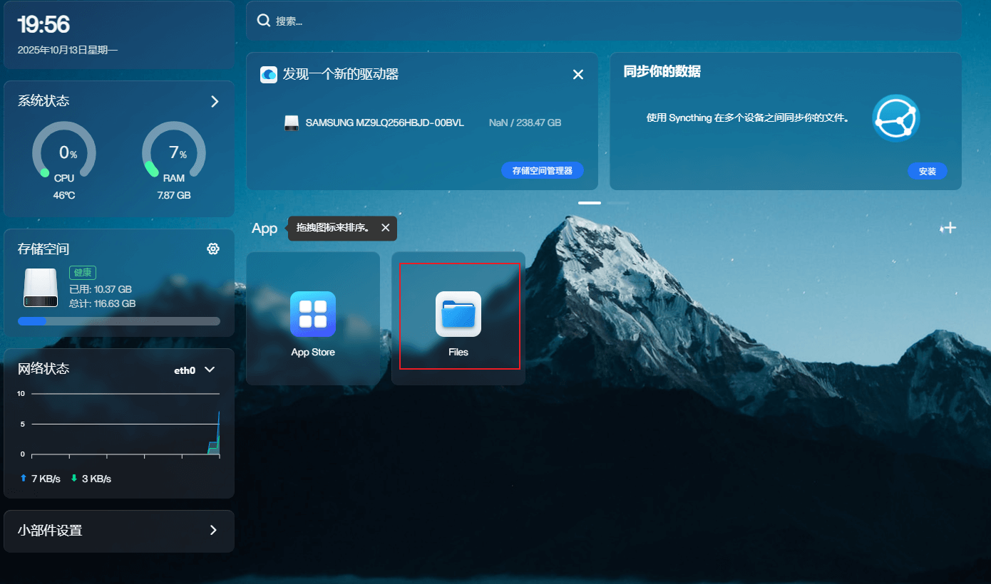

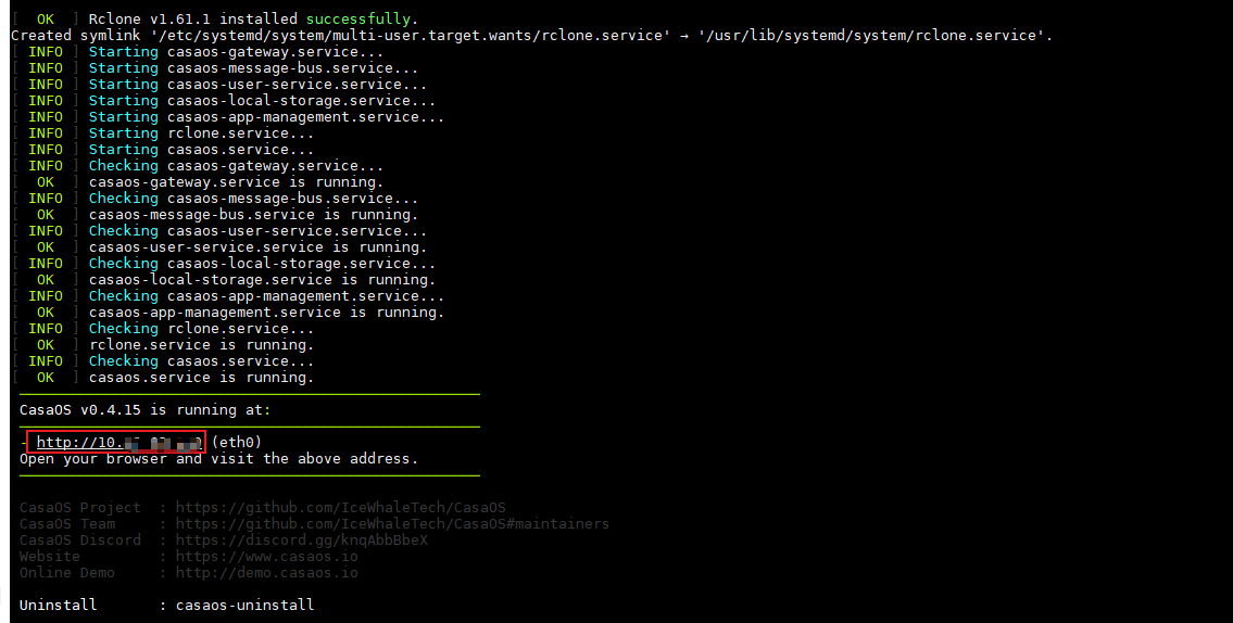

  • Install CasaOS
curl -fsSL https://get.casaos.io | sudo bash
After successful installation, copy the URL in the red box and open it in the browser.
After creating a user, log in and click Files. After finding the folder mounted on the NAS server in the Root directory, you can directly upload, delete, modify, etc.
