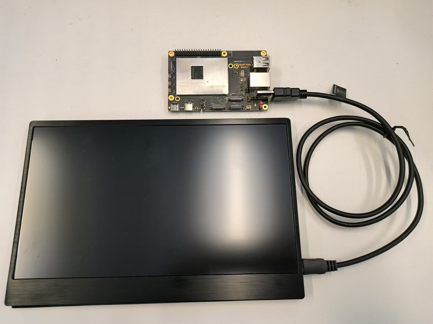

HDMI Display Connection
Connect the display as shown below:
Image 1

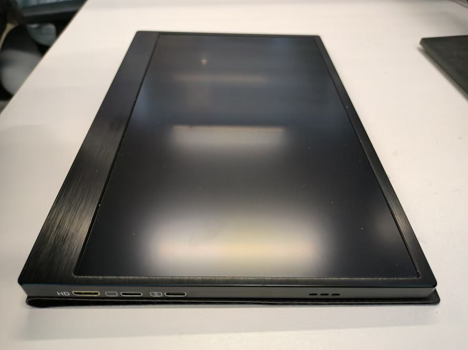

11.6-inch HDMI Display
Image 3
Quectel Pi H1 Connected to HDMI Display
HDMI Display with Weston Desktop
After connecting the HDMI display and powering on the device, start the display service with systemctl start init_display. The HDMI display will then show the Weston desktop.
