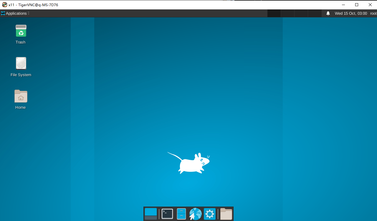

4. Test connection
# Connect from another computer, enter the password as prompted to log in
# For example, vncviewer 10.66.82. *: 5901
Vncviewer<Device IP Address>: 5901
  • After successful connection, you will see the following screen

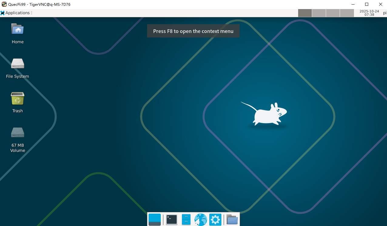

6. Test connection
# For example, vncviewer 10.66.82. *: 5900
Vncviewer<Device IP Address>: 5900
