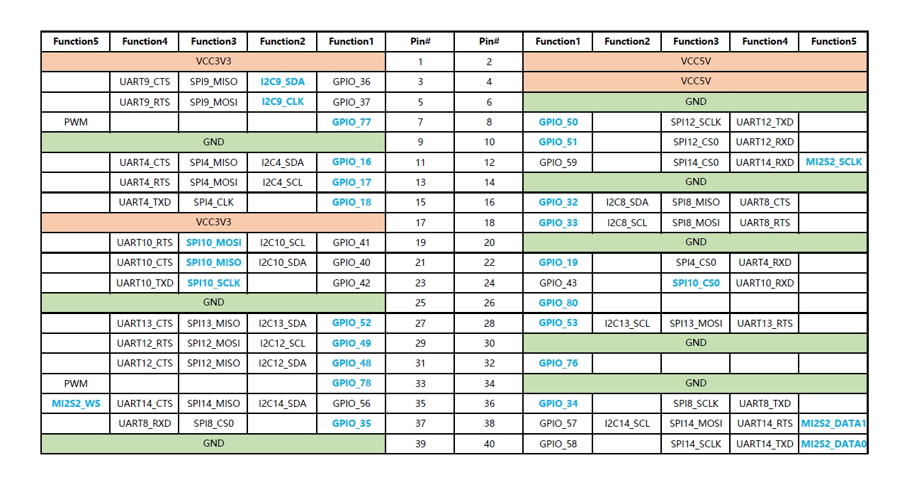

40PIN Testing
The configuration files for some low-speed interfaces in the 40PIN (i2c9/spi10/UART 12_2w/i2c13/si14) can be found in /etc/quecpi_config/quecpi_config.ini. The configuration steps are as follows:
  1. Modify quecpi_config.ini configuration
  2. Application configuration
quecpi_config 40pin set

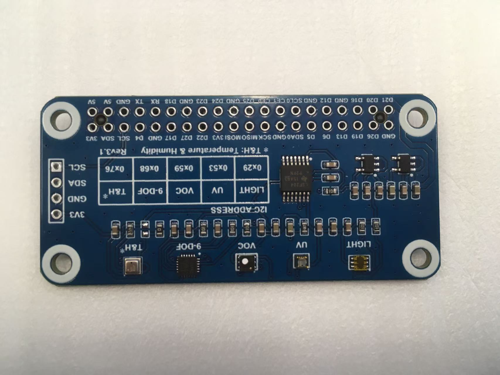

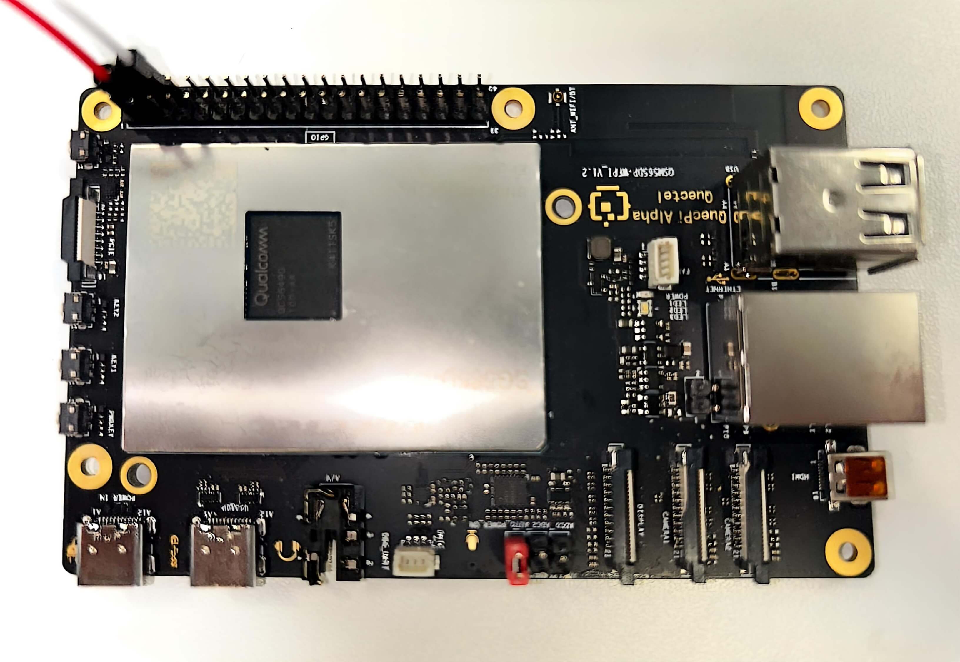

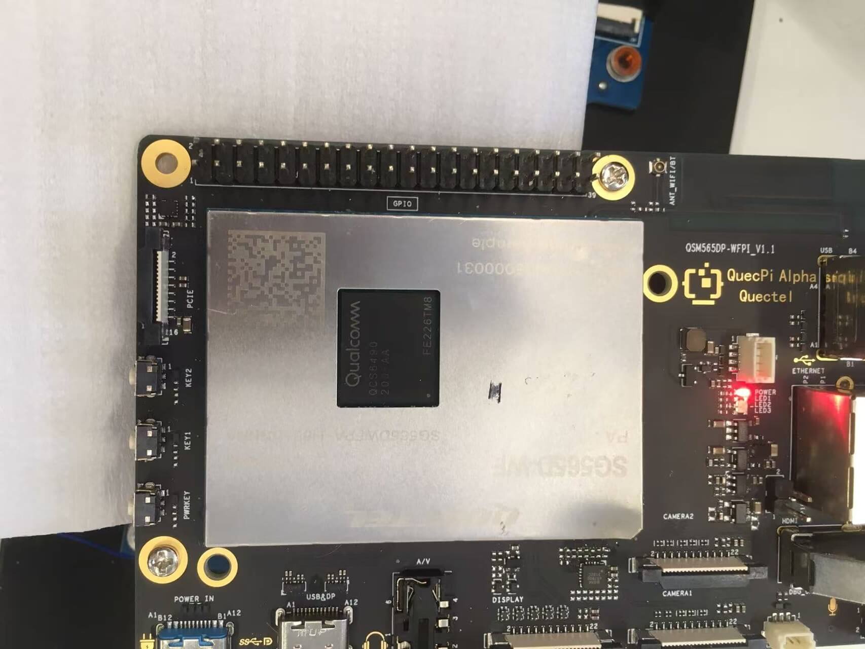

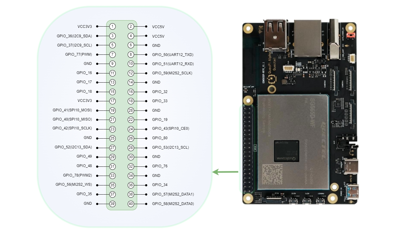

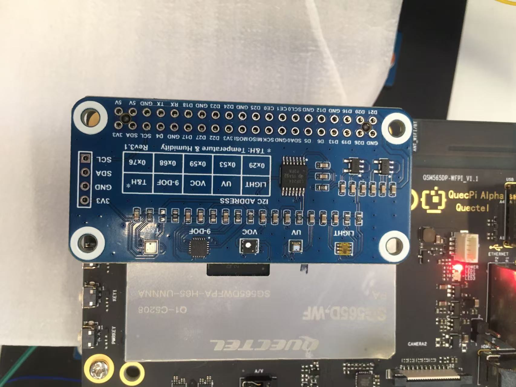

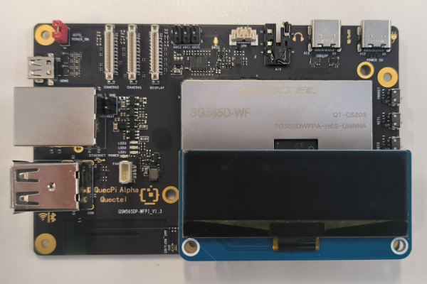

I2C Testing
Pin3 and pin5 from 40PIN are configured as data and clock pins of I2C by default,Corresponding device node /dev/i2c9, if the node is not available, you can first use quecpi_config at the beginning of this chapter to configure and enable it.
To test the I2C interface, connect an external I2C device, such as the Waveshare Environmental Sensor Expansion Board, via 40pPIN pins .
Connection diagram:
Image 1
Image 2
QuecPi 40PIN Pins
Image 3
Quectel Pi H1 with Environmental Sensor Expansion Board

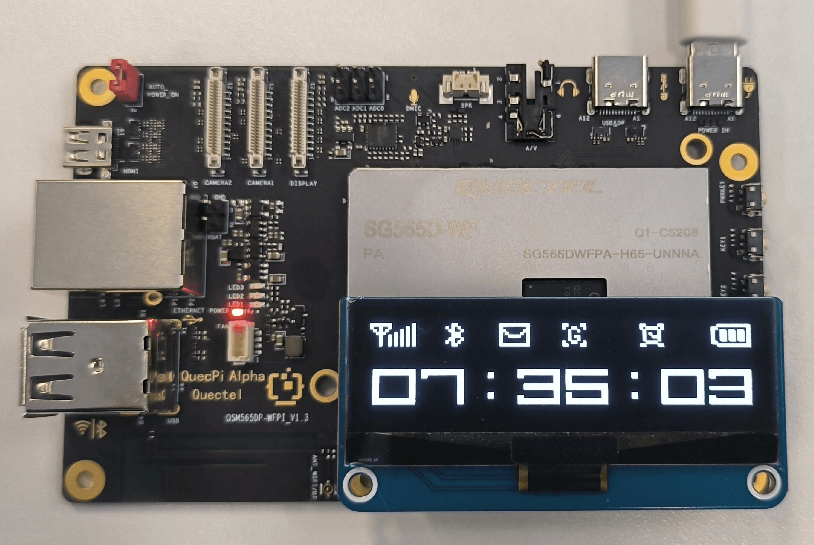

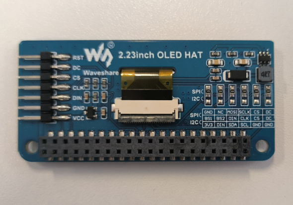

SPI Testing
Test SPI function of 40pin with Waveshare 2.23 inc OLED displayer,Corresponding device node /dev/spi10, if the node is not available, you can first use quecpi_config at the beginning of this chapter to configure and enable it.
Connection diagram:
Waveshare OLED displayer
Quectel Pi H1 with Waveshare OLED displayer
Test steps:
  • wget http://www.waveshare.net/w/upload/c/c5/2.23inch-OLED-HAT-Code.7z #Download source code from Waveshare
  • 7z x 2.23inch-OLED-HAT-Code.7z #Extract the source code
  • cd 2.23inch-OLED-HAT-Code/Without\ scrolling/Raspberry\ Pi/SPI/c #Navigate to the source directory
  • Modify the source code according to the content of the following patch:
    diff -r -u "2.23inch-OLED-HAT-Code/Without scrolling/Raspberry Pi/c/examples/main.c" quecpi/c/examples/main.c
    --- "2.23inch-OLED-HAT-Code/Without scrolling/Raspberry Pi/c/examples/main.c"	2023-12-20 03:19:38.000000000 +0000
    +++ quecpi/c/examples/main.c	2025-08-15 07:34:39.959415415 +0000
    @@ -17,10 +17,13 @@
         char value[10]={'0', '1', '2', '3', '4', '5', '6', '7', '8', '9'};
         time_t now;
         struct tm *timenow;
    -    if(DEV_ModuleInit() != 0) {
    -		return -1;
    +    extern int GPIO_Handle;
    +    extern int SPI_Handle;
    +    GPIO_Handle = lgGpiochipOpen(4); if (GPIO_Handle < 0) { printf( "gpiochip4 Export Failed\n"); return -1; }
    +    lgGpioClaimOutput(GPIO_Handle, 0, 119     , LG_LOW); //enable OLED_DC mode
    +    lgGpioClaimOutput(GPIO_Handle, 0, OLED_RST, LG_LOW);
    +    lgGpioClaimOutput(GPIO_Handle, 0, OLED_DC , LG_LOW);
    +    SPI_Handle = lgSpiOpen(10, 0, 10000000, 0);
         SSD1305_begin();
         SSD1305_bitmap(7, 0, waveshare_ch,112,32);
         SSD1305_display();
    Only in quecpi/c/lib/Config: .DEV_Config.h.un~
    diff -r -u "2.23inch-OLED-HAT-Code/Without scrolling/Raspberry Pi/c/lib/Config/DEV_Config.h" quecpi/c/lib/Config/DEV_Config.h
    --- "2.23inch-OLED-HAT-Code/Without scrolling/Raspberry Pi/c/lib/Config/DEV_Config.h"	2023-12-20 03:23:11.000000000 +0000
    +++ quecpi/c/lib/Config/DEV_Config.h	2025-08-15 07:32:05.844626084 +0000
    @@ -41,8 +41,8 @@
     //OLED Define
     #define OLED_CS         8
    -#define OLED_RST        25
    -#define OLED_DC         24
    +#define OLED_RST        19
    +#define OLED_DC         33
  • Compile: make
  • Run: ./main
  • Expected output:

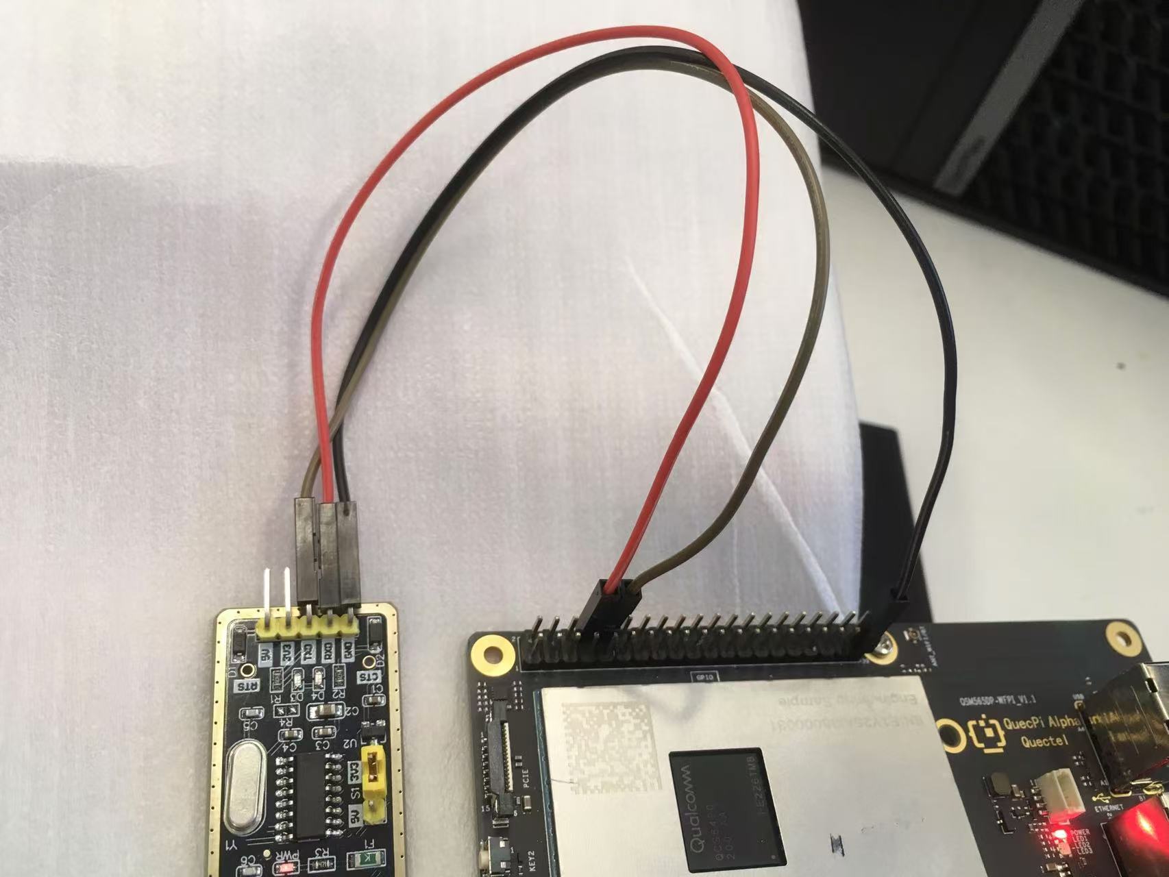

UART Testing
Configure pin8 and pin10 from 40PIN to UART functionality by default,Corresponding to device node /dev/ttyHS2, if the node is not available, you can first use quecpi_config at the beginning of this chapter to configure and enable it.
Connect the RX of a USB-to-serial module to pin8 and the TX to pin10.
Connection diagram: ![](images/quecpi-40pin-pin8.jpg)
