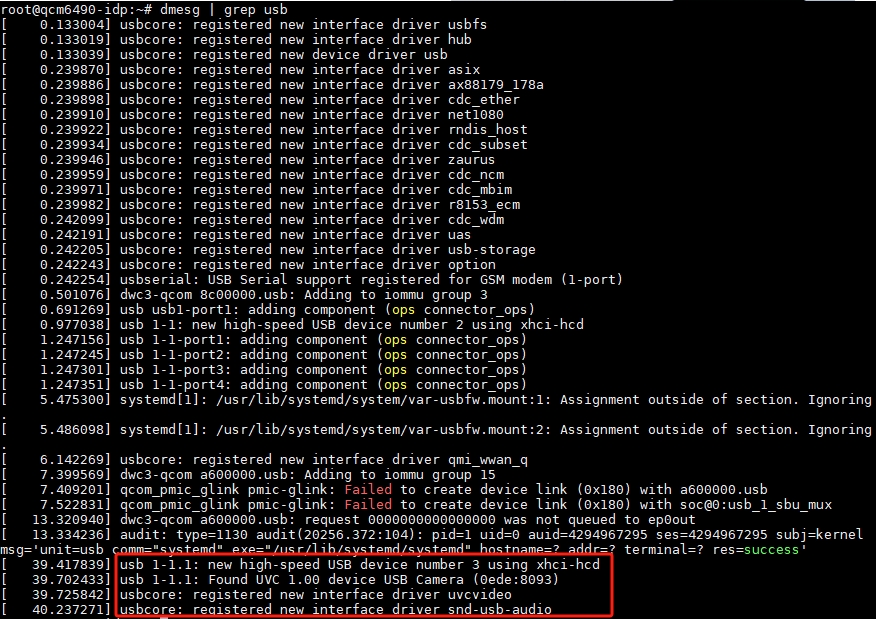

  1. Run the following command in the SSH terminal to view the USB device information recognized by the system:
dmesg | grep usb
