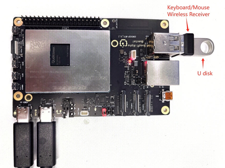

USB Host Testing
A USB Host refers to a system or hardware capable of controlling and managing USB devices. It is responsible for providing power, data transmission, and management functions for connected USB devices such as USB flash drives, keyboards, and mice. The following are some common functions and application scenarios of USB Hosts.
Insert example:
U Disk Mounting
When the USB flash drive is inserted into the USB Host of Quectel Pi H1, the system detects a USB flash drive and successfully initializes it as a storage device. View the log through "dmesg -n 8":
usb 1-1.2: new high-speed USB device number 7 using xhci-hcd
[  806.667878][  T162] usb-storage 1-1.2:1.0: USB Mass Storage device detected
[  806.676812][  T162] scsi host1: usb-storage 1-1.2:1.0
[  808.172742][  T162] scsi 1:0:0:0: Direct-Access     USB      Flash Disk       1100 PQ: 0 ANSI: 4
[  808.189763][   T74] sd 1:0:0:0: [sdg] 15730688 512-byte logical blocks: (8.05 GB/7.50 GiB)
[  808.200512][   T74] sd 1:0:0:0: [sdg] Write Protect is off
[  808.207624][   T74] sd 1:0:0:0: [sdg] Mode Sense: 43 00 00 00
[  808.216028][   T74] sd 1:0:0:0: [sdg] Write cache: enabled, read cache: enabled, doesn't support DPO or FUA
[  808.244091][   T74]  sdg: sdg1

USB Keyboard and Mouse
When the Logitech USB wireless receiver is plugged into the USB Host on the Quectel Pi H1, the keyboard and mouse can function normally. For detailed information, you can view the log using the command "dmesg -n 8", which shows the process of the Logitech USB wireless receiver (model 046D:C534, Logitech keyboard/mouse kits) being successfully recognized and initialized by the Linux system.
