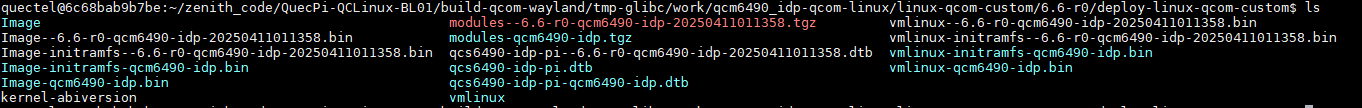

bitbake linux-qcom-custom
The kernel image will be generated at (temporarily cached in work directory): build-qcom-wayland/tmp-glibc/work/qcm6490_idp-qcom-linux/linux-qcom-custom/6.6-r0/deploy-linux-qcom-custom/.
Yocto copies the kernel image of the above directory to build-qcom-wayland/tmp-glibc/deploy/images/qcm6490-idp/. To facilitate the packaging of the kernel image file and execute the subsequent process, the script will obtain the kernel image from this directory.
