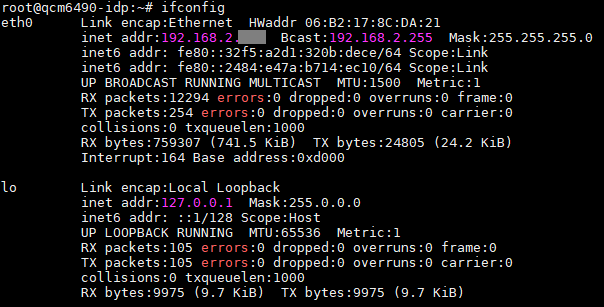

1.Obtaining Quectel Pi H1's IP Address
Execute ifconfig in the debug UART terminal to view the Quectel Pi H1's IP address.
