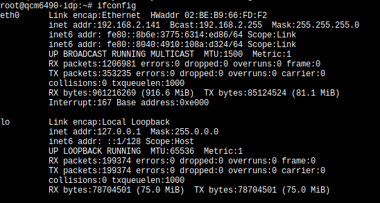

Execute ifconfig to check the network interface address:

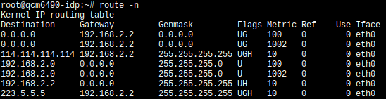

Execute route -n to view network routing information, including the default gateway:
