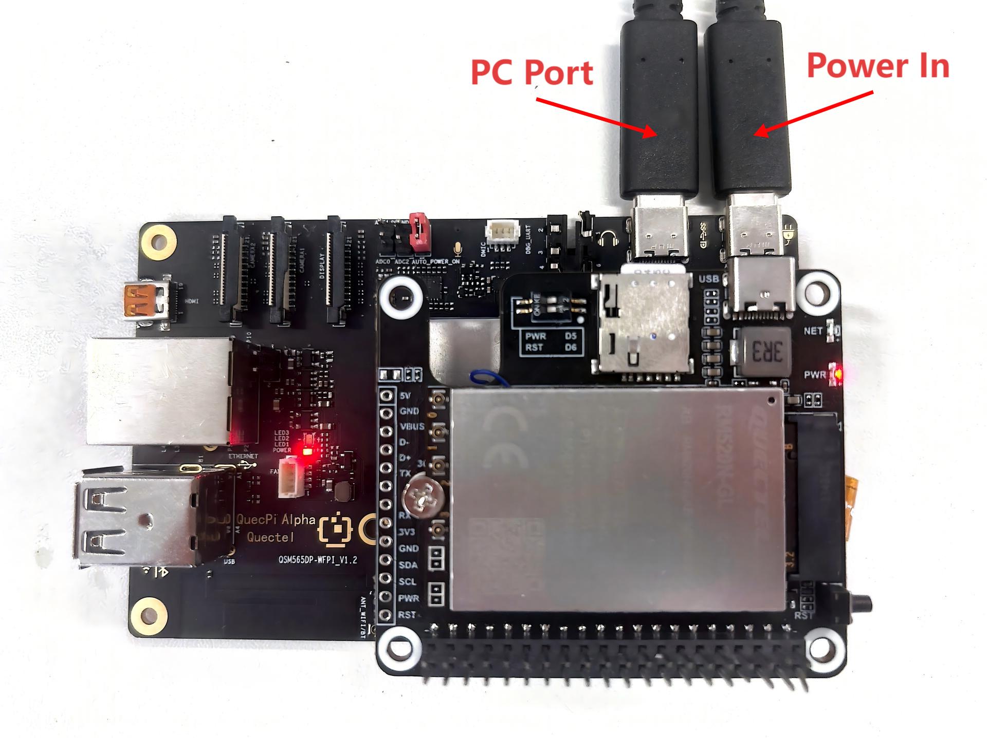

To use the PCIE passthrough adapter, the module needs to be set to the PCIE-EP mode. Only in this way can it communicate with the PCIE interface of the Quectel Pi H1. After installing the module driver, connect to the 5G module through the USB port of the adapter board and input the AT command to switch it to the PCIE-EP mode.
1.Use a TYPE-C To USB adapter to connect to a Windows computer (at this point, you may need to install the driver. The driver files are provided by the module technical support. Please select the appropriate driver file according to the corresponding module for installation.)
2.Use the serial port tool to open the AT port of the module.
You can check the ports in the device manager. The "Quectel USB AT Port (COM***)" port will appear.
AT+QCFG="data_interface",1,0
AT+QCFG="pcie/mode",0
AT+QCFG="usbnet",2
AT+CFUN=1,1
After executing the instructions, unplug the USB port on the PC and re-power on the QuecPI. Then, using the following command through the shell interface, check whether the device is properly recognized and connected.

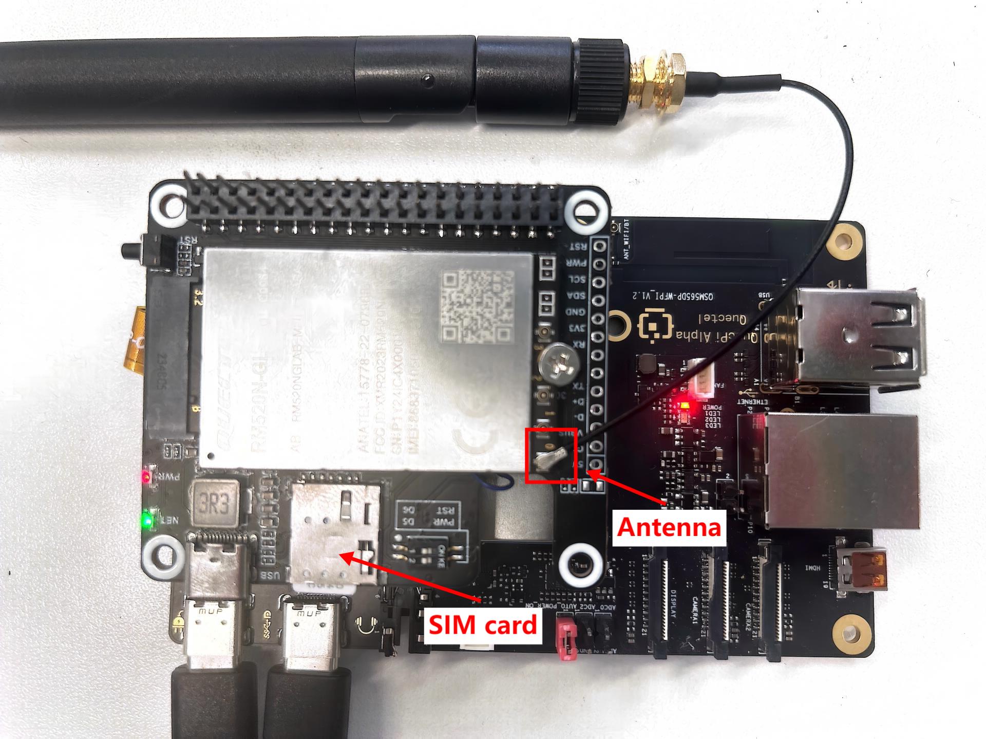

To perform dial-up internet access using the quectel-CM tool, first connect the antenna to the 5G module and insert the SIM card to ensure a stable connection. Avoid attempting to access the internet if the signal is weak.
After confirming there are no errors, directly run the quectel-CM command in the background to make the call.
