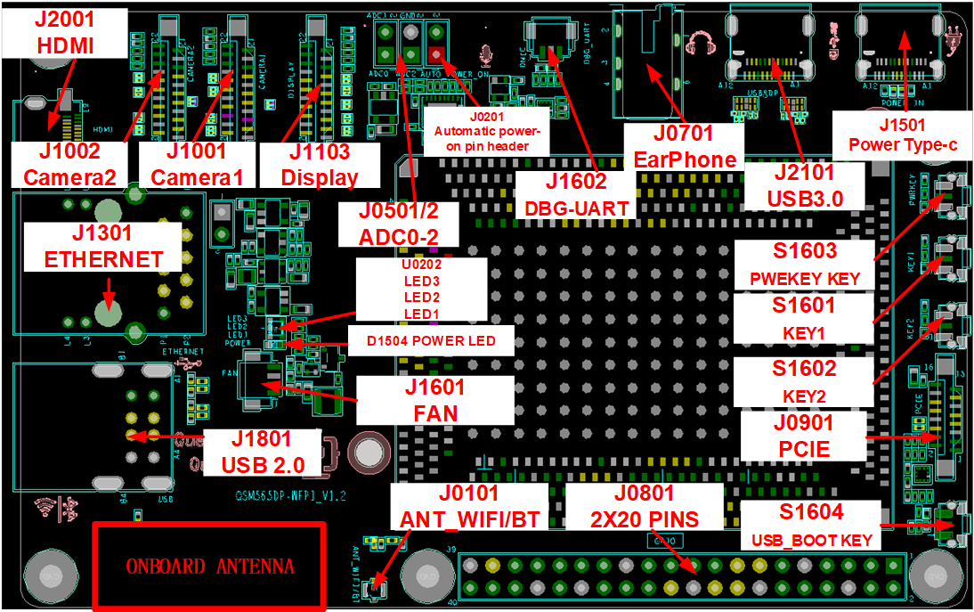

Top View Interface Diagram

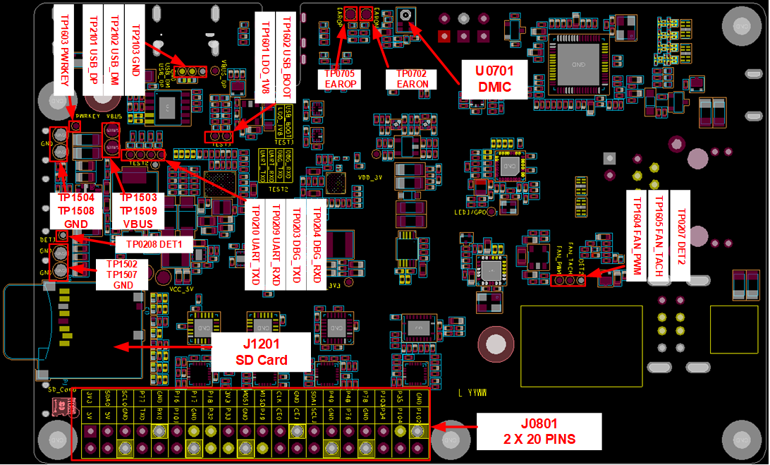

Bottom View Interface Diagram
