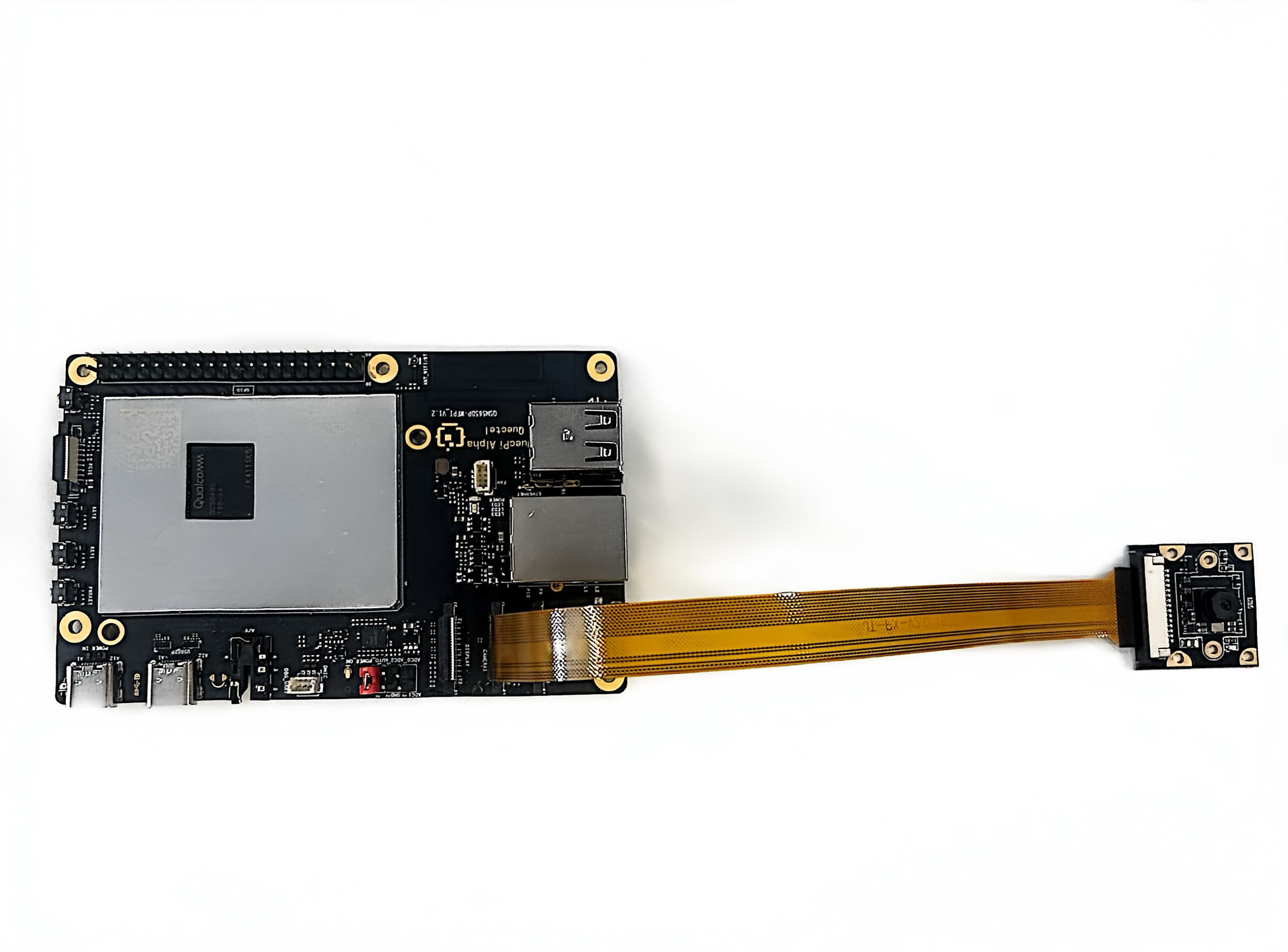

Camera Connection
Connect as shown in the figure below. When connecting, pull up the black latch part of the connector, Insert the FPC cable into the first CSI card slot. Note that the metal contact surface should face the inner metal contact surface of the board. Press the latch and confirm that the FPC cable is stable and not loose.
