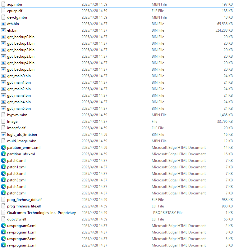

Obtain the Image
Image Path: workspace/quectel_build/QSM565DWFPARL1A01_BP01.001_Linux6.6.38_V01.
Example files (partial):
