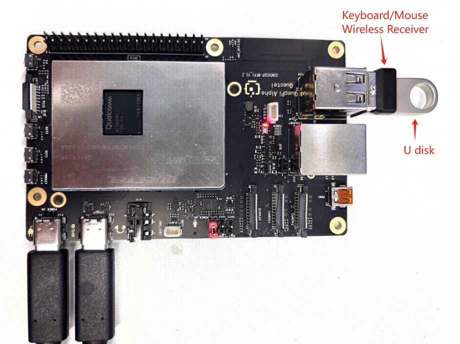

USB Keyboard and Mouse
When the Logitech USB wireless receiver is plugged into the USB Host on the PI-SG565D, the keyboard and mouse can function normally. For detailed information, you can view the log using the command "dmesg -n 8", which shows the process of the Logitech USB wireless receiver (model 046D:C534, Logitech keyboard/mouse kits) being successfully recognized and initialized by the Linux system.
