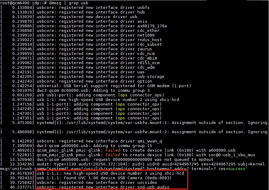

  1. Run the following command in the SSH terminal to view the USB device information recognized by the system:
dmesg | grep usb

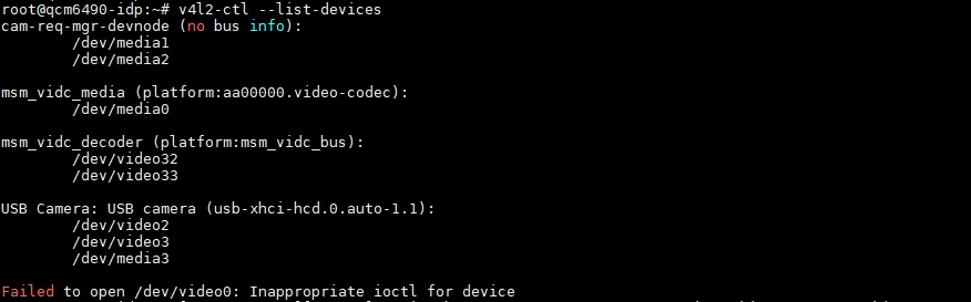

  1. Run the following command in the SSH terminal to view the newly added device nodes:
v4l2-ctl --list-devices
  • /dev/video2 - Main video node, the gst command later mainly operates on this node
  • /dev/video3 - Metadata node
  • /dev/media3 - Hardware topology controller that controls the entire pipeline

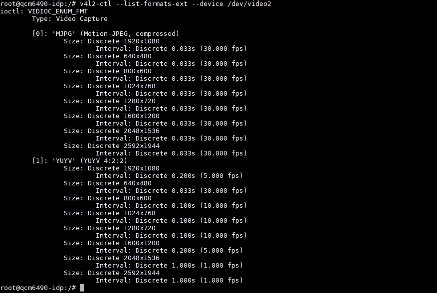

  1. Run the following command in the SSH terminal to view the formats supported by the video node:
v4l2-ctl --list-formats-ext --device /dev/video2
  • As shown in the figure, the camera supports image output in both MJPG and YUYV formats.
