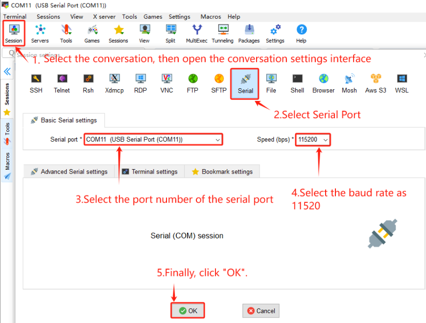

MobaXterm Installation
Install MobaXterm (or alternatives like Xshell/SecureCRT). Here, take MobaXterm as an example.Click to download https://developer.quectel.com/doc/files/MobaXterm_11.0.rar.
Decompress the package and click MobaXterm.exe to launch the installer.
After installation, click MobaXterm to pop up the window below. Click Session to open the "Session settings" window. Click "Serial" and select the corresponding serial port. Select
115200
for the "Speed" item (Baudrate) and click "OK", as shown below.
