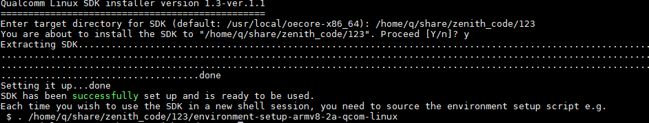

- Deployment
Execute the following command in an Ubuntu 22.04 system:
./qcom-wayland-x86_64-qcom-multimedia-image-armv8-2a-qcm6490-idp-toolchain-1.3-ver.1.1.sh
You will be prompted to enter the deployment directory. You can use the default directory or specify a custom path. After execution, instructions for enabling the SDK environment will be displayed. Below is an example of the deployment process:
