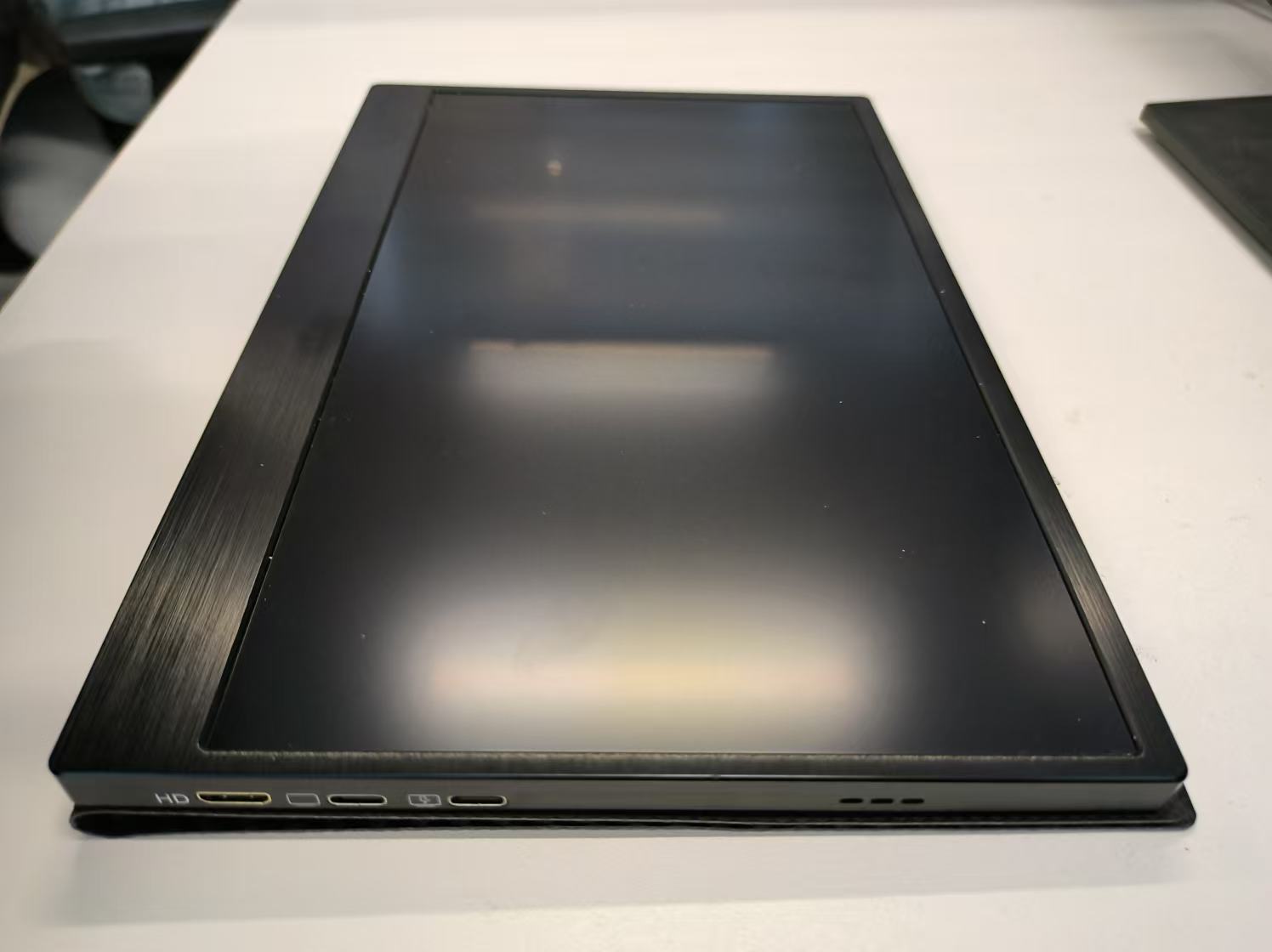

11.6-inch HDMI Display

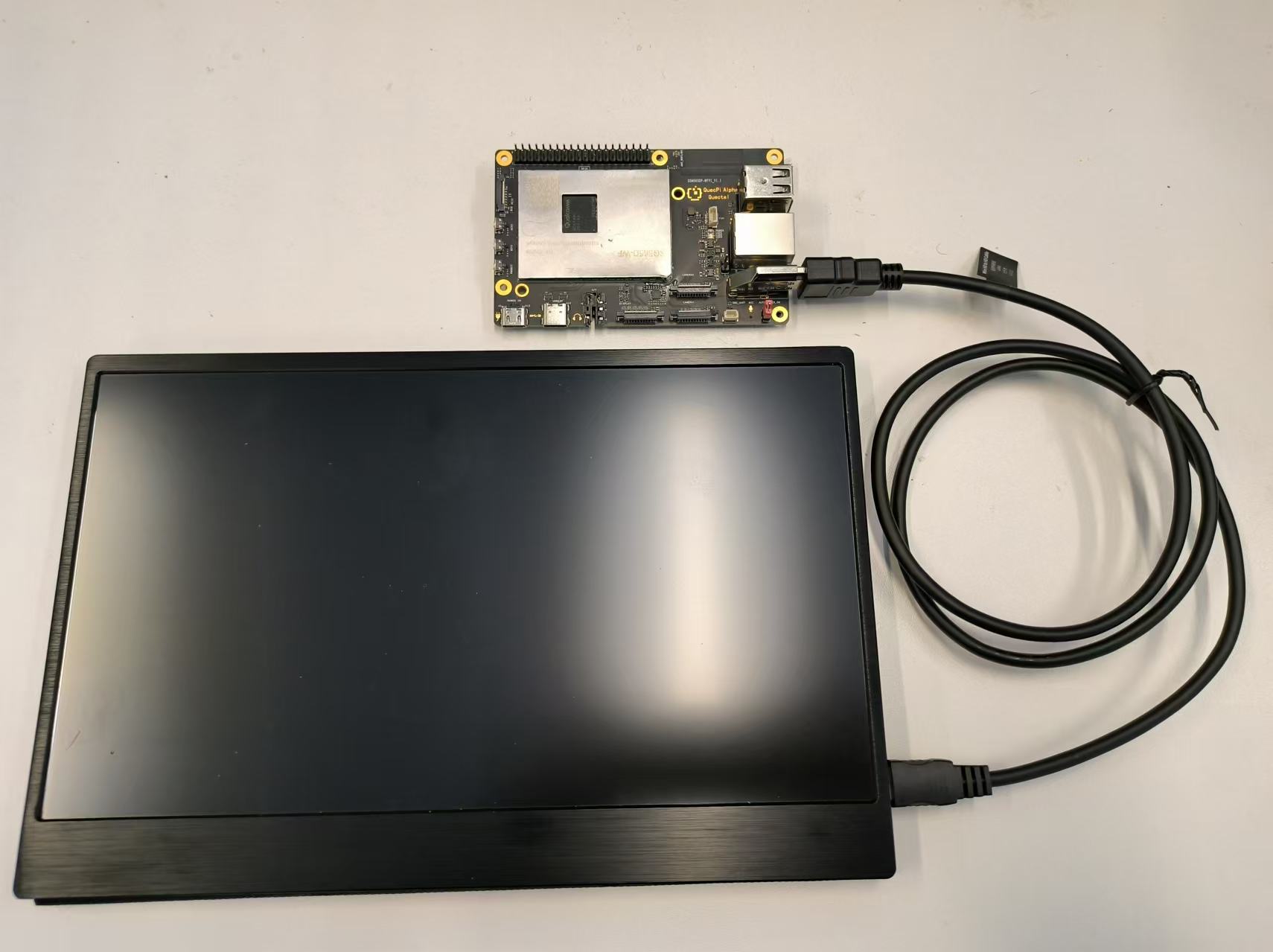

PI-SG565D Connected to HDMI Display

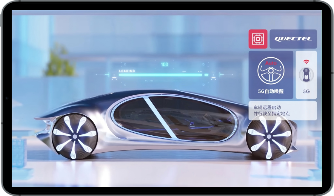

Video playback effect:
