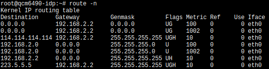

Execute route -n to view network routing information, including the default gateway:
