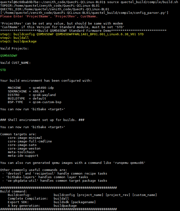

Set up the Build Environment
source quectel_build/compile/build.sh
Configure a Custom Build
Enter your customized "ProjectName", "ProjectRev" and "CustName" based on the prompts. Select valid entries from Valid Projects and Valid CUST_NAME.
Step 1:
buildconfig QSM565DWF SG565DWFPARL1A01_BL01BP01K0M01_QDP_LP6.6.0XX.01.00X_V0X STD

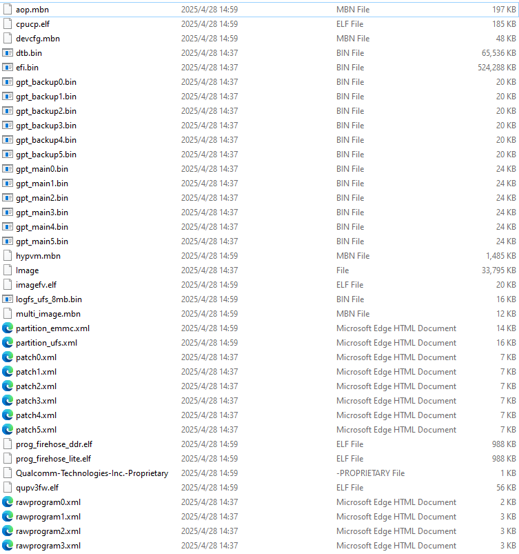

Obtain the Image
Image Path: workspace/quectel_build/QSM565DWFPARL1A01_BP01.001_Linux6.6.38_V01.
Example files (partial):
