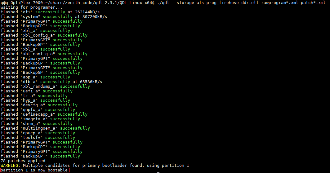

Run the QDL executable in the QDL_Linux_x64 directory with the following command:
./qdl --storage ufs prog_firehose_Qcm6490_ddr.elf rawprogram*.xml patch*.xml
A successful flash is indicated by the message "partition 1 is now bootable" in the terminal window, as shown below:

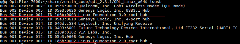

After flashing, view the device information in the terminal window by executing Isusb. See the example below:

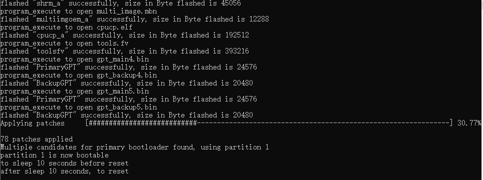

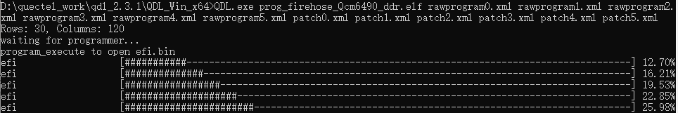

3.Open the Cmd window and use the following command to run the QDL executable file in the QDL_Win_x64 directory.
The burn operation was successful as shown in the following picture:

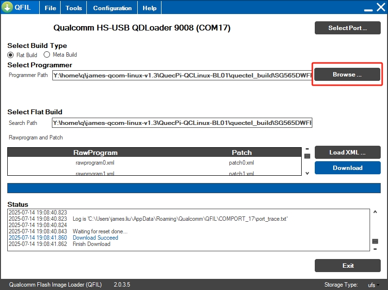

If QFIL burning software is installed on your computer, you can use it for image burning.

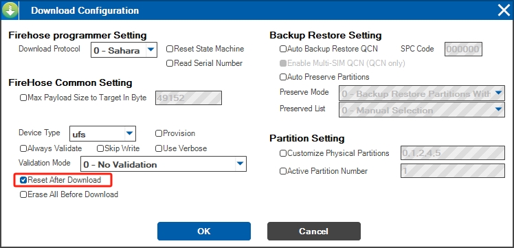

- Click on the Configuration button, click on the FireHose Configuration button that pops up, select the Reset After Download option box, and click the OK button.

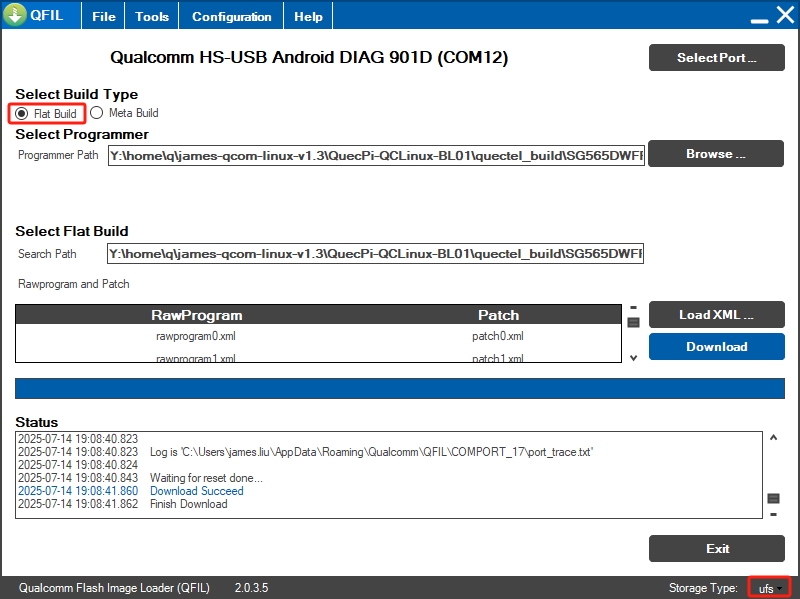

2. Choose Flat Build as the build type and ufs as the storage type in the bottom right corner.

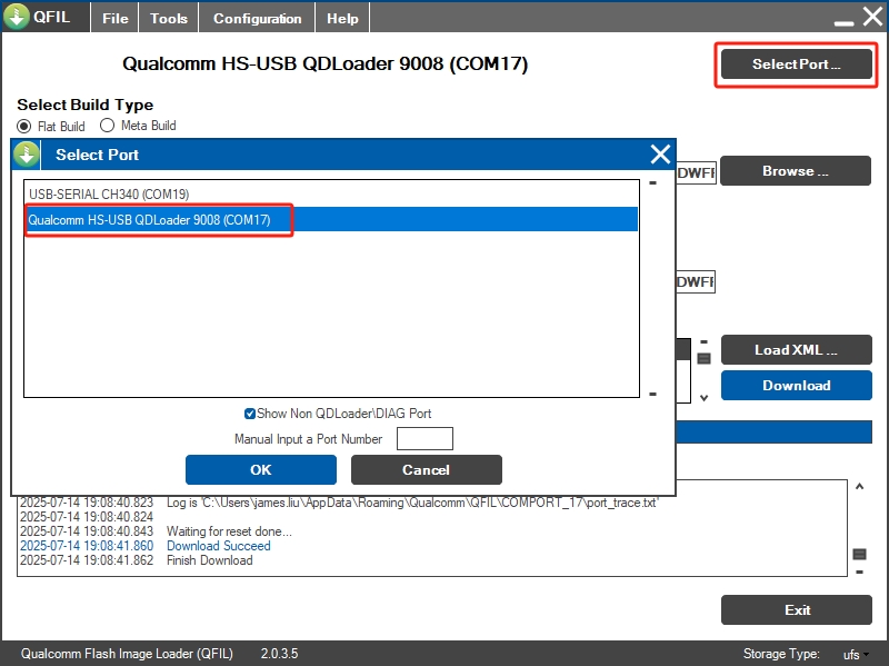

3. Press and hold the EMG_DOWNLOAD button on QuecPi Alpha, power on the system, click the SelectPort button, select port 9008 , and click the OK button.

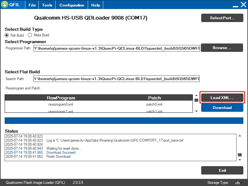

4. Click the Browse button and select the prog_firehose_Qcm6490uddr.elf file.

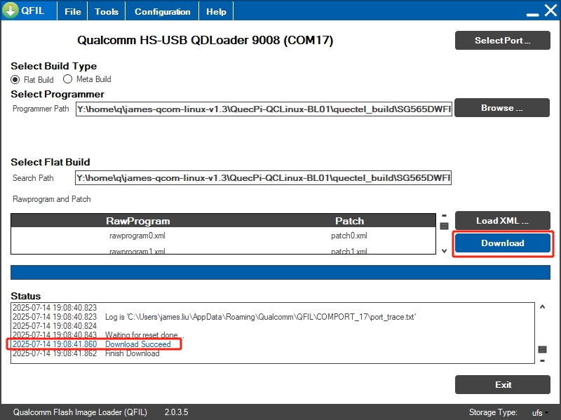

5. Click the LoadXML button and select all rawprogram#. xml files and patch#.xml files.
6. Click the Download button. When the words Download Succeed appear in the Status information box, it means that the burning is successful and the system will automatically restart.
