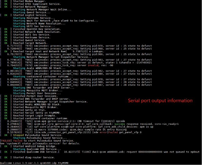

After powering on, the serial port will output the following data:
