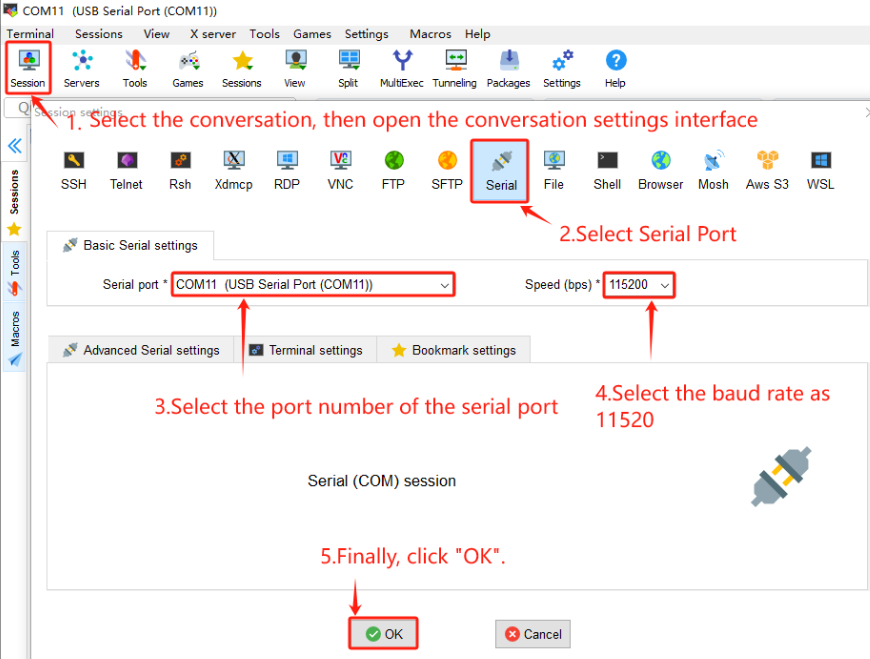

After installation, click MobaXterm to pop up the window below. Click Session to open the "Session settings" window. Click "Serial" and select the corresponding serial port. Select
115200
for the "Speed" item (Baudrate) and click "OK", as shown below.
