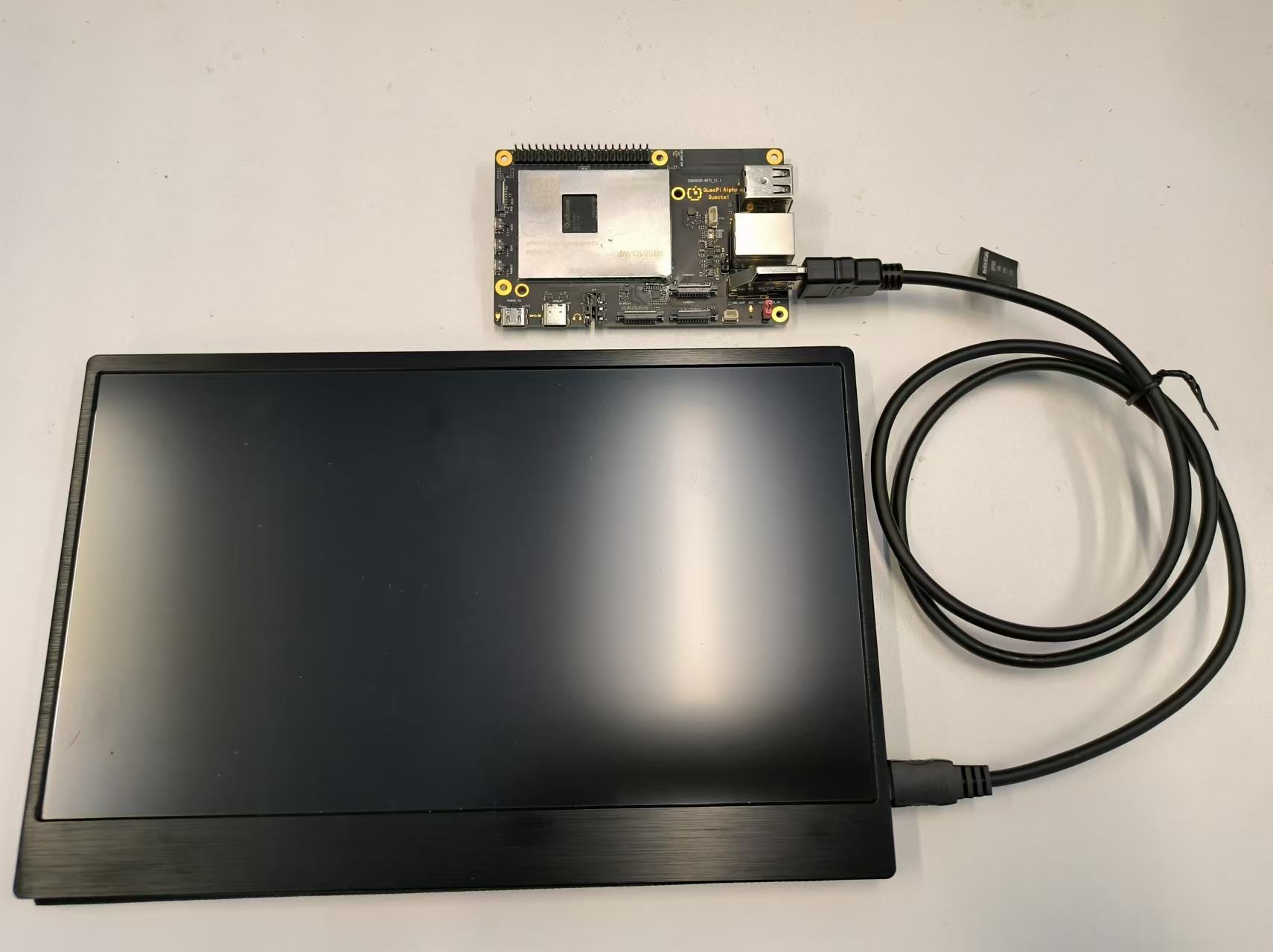

HDMI Display Connection
Connect the display as shown below:

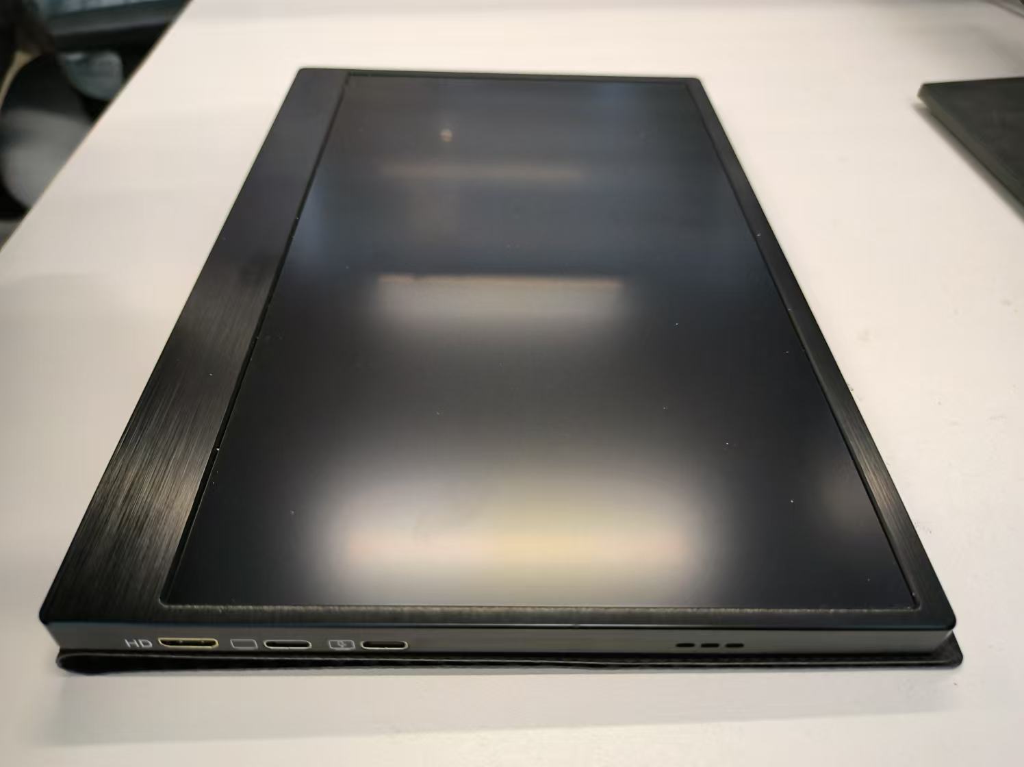

11.6-inch HDMI Display

QuecPi Alpha Connected to HDMI Display

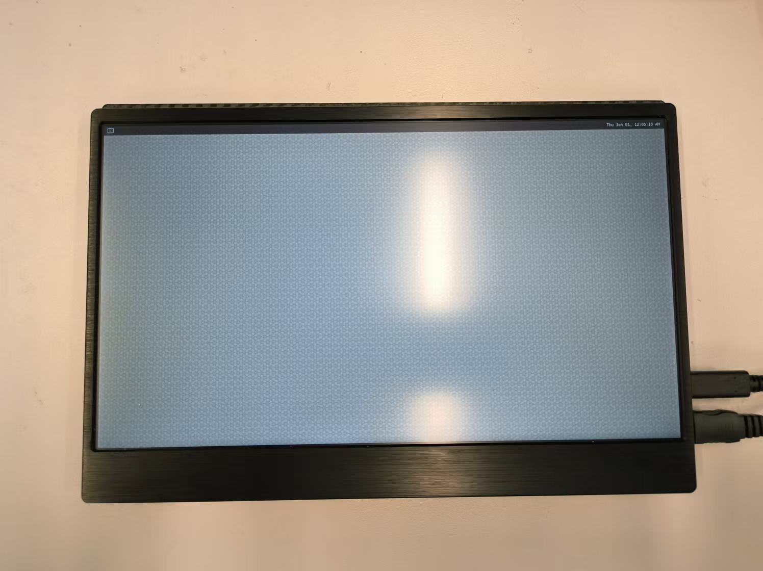

HDMI Display with Weston Desktop
After connecting the HDMI display and powering on the device, start the display service with systemctl start init_display. The HDMI display will then show the Weston desktop.
Display effect:

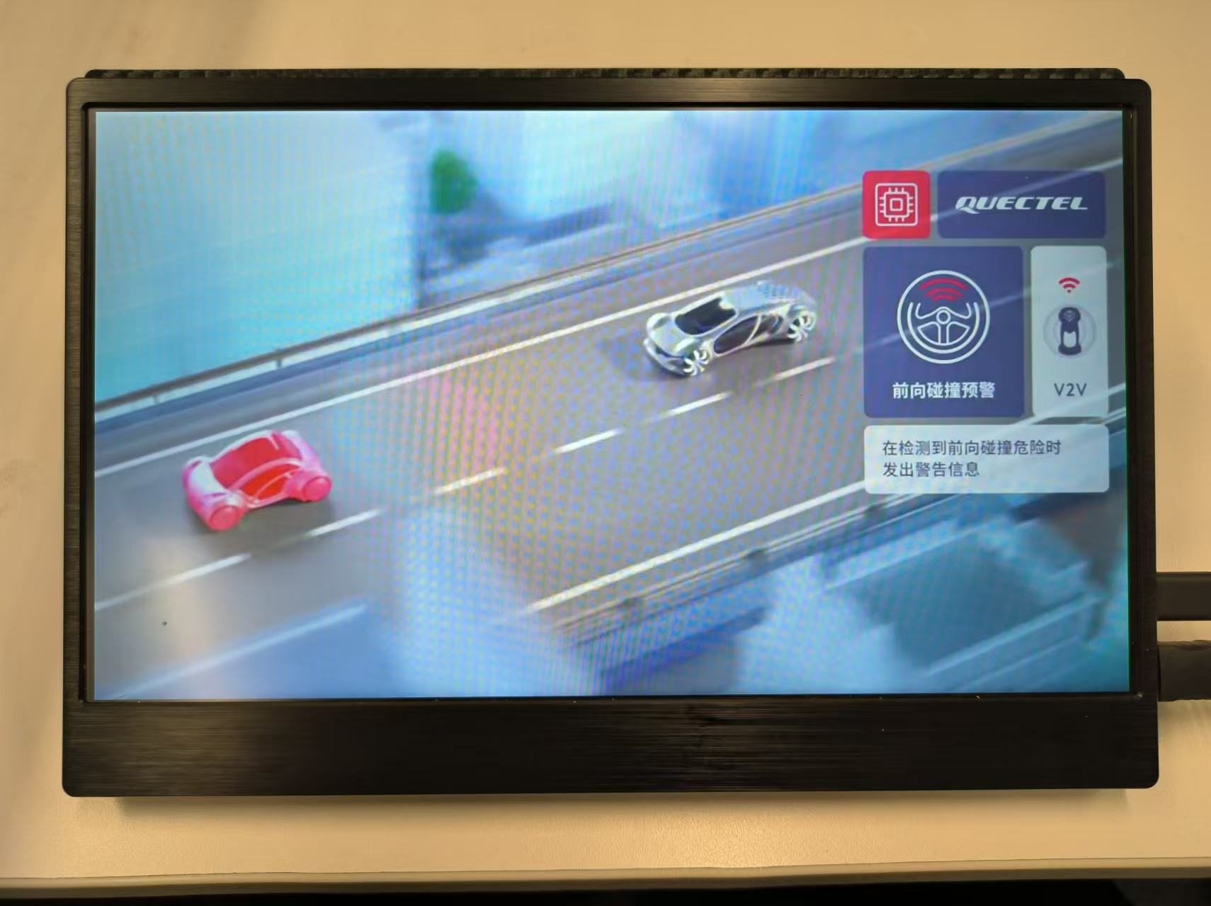

  • ! waylandsink enable-last-sample=false fullscreen=true: waylandsink outputs decoded video to a Wayland display server. enable-last-sample=false disables the 'last sample' feature, which is typically done for performance optimization or to avoid certain problems. fullscreen=true displays the video in fullscreen mode.
Video playback effect:
