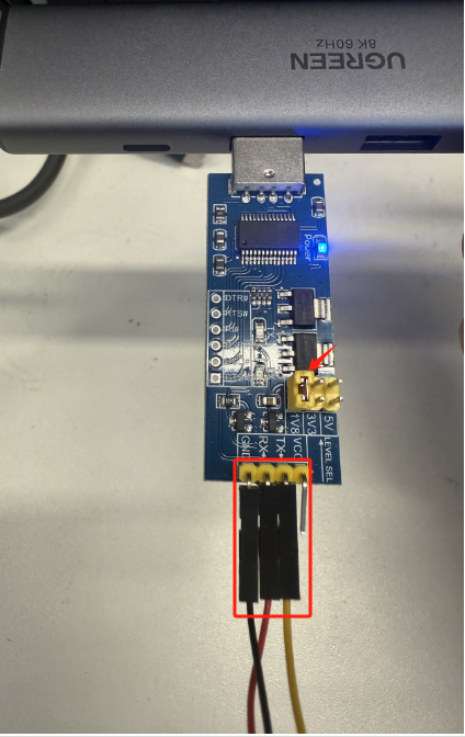

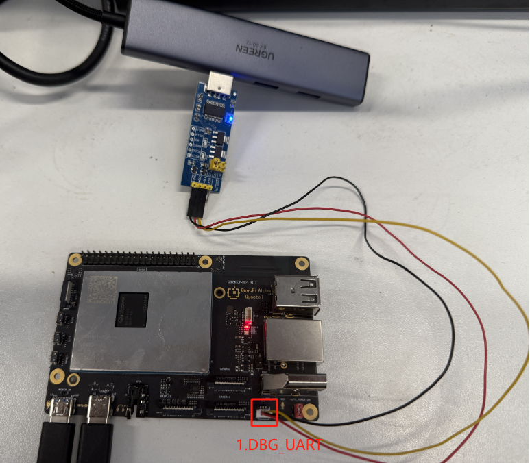

Debug Cable Connection
During development, communication with QuecPi Alpha is typically performed via UARTs. Network is also a possible way for communication but it requires QuecPi Alpha's IP address first. Therefore, UARTs are essential for communication setup.
Locate the connector labeled “DBG_UART” (the debug UART) and connect it to a USB-to-serial converter debug UART cable. The other end should be plugged into a USB port on your computer (or a USB hub).
Wiring diagram:
