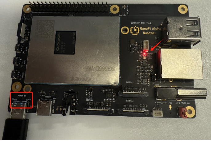

  3. Power on
    Plug the charger plug into a powered electrical outlet. Connect the Type-C end of the cable to the port labeled "POWER IN". After powering on, the POWER indicator will turn red (as shown by the red arrow in the figure below). Verify if the device is receiving power correctly.
