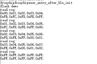

Function Debugging
To debug the flash function, use the EVB (e.g., HCM111Z TE-B) installed with the module and follow these steps:
  1. Run the flash demo described in Operation Procedure.
  2. Recompile the firmware version.
  3. Download the new firmware version to the module.
  4. Restart the module.
  5. Open UART 1 port to get log information.
Log Obtained via a Serial Port Tool
The log data in the figure above shows that writing data to flash, reading data from flash and erasing data in flash are all successful.

void demo_flash(void)
    uint32_t id;
    ql_debug("flash demo\r\n");
    ql_flash_set_security(QL_FLASH_PROTECT_NONE);
    ql_flash_erase(USER_FLASH_BASE_ADDR, FLASH_PAGE_SIZE);
    uint32_t idx = 0;
    for(idx=0; idx<FLASH_PAGE_SIZE; idx++)
        buf[idx] = idx;
    ql_flash_write(buf,USER_FLASH_BASE_ADDR, FLASH_PAGE_SIZE );
        buf[idx] = 0xff;
    ql_flash_read(buf,USER_FLASH_BASE_ADDR, FLASH_PAGE_SIZE);
    ql_debug("read reg:\r\n");
    show_reg(buf,5,1);
    show_reg(buf+4091,5,1);
        buf[idx] = idx+1;
    flash_write(USER_FLASH_BASE_ADDR, FLASH_PAGE_SIZE, buf);
        buf[idx] = 0xfe;
    flash_read(USER_FLASH_BASE_ADDR, FLASH_PAGE_SIZE, buf);
    show_reg(buf,5,1);
    ql_flash_erase(USER_FLASH_MAX_PAGE_ADDR, FLASH_PAGE_SIZE);
        buf[idx] = idx+2;
    ql_flash_write(buf,USER_FLASH_MAX_PAGE_ADDR, FLASH_PAGE_SIZE);

Function Debugging
