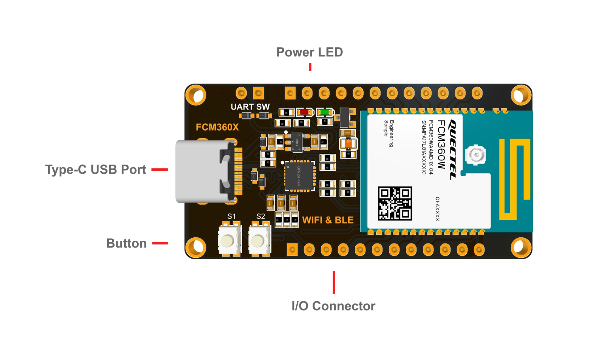

The QuecPython_FCM360W_EVB development board is a compact and portable "pocket-sized" board designed specifically for QuecPython. It features a Type-C interface, allowing developers to easily use the board with just a USB Type-C data cable.
Feature Description
The main components and interface layout of the EVB are shown in the figure below.

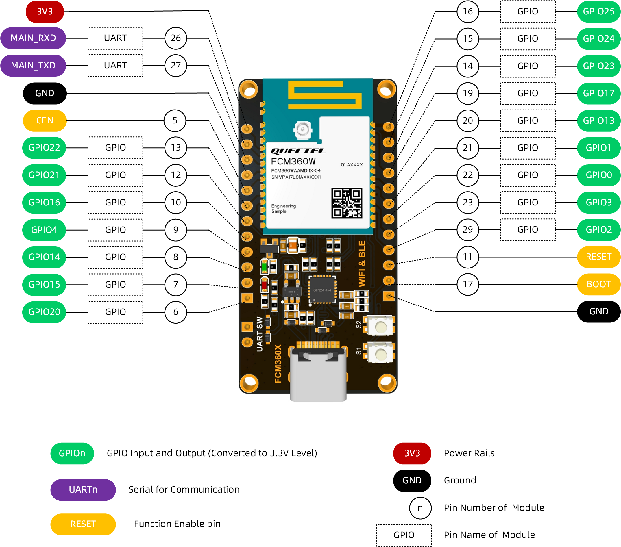

EVB Interface
J1 Pin Assignment
| Pin Header | Pin No. | Name | Feature |
| J1 | - | VCC_3V3 | 3.3 V |
| J1 | 26 | MAIN_RXD | UART0 |
| J1 | 27 | MAIN_TXD | UART0 |
| J1 | - | GND | Ground |
| J1 | 5 | CEN | Module enable control |
| J1 | 13 | IO22 | GPIO22 |
| J1 | 12 | IO21 | GPIO21 |
| J1 | 10 | IO16 | GPIO16 |
| J1 | 9 | IO4 | GPIO4 |
| J1 | 8 | IO14 | GPIO14 |
| J1 | 7 | IO15 | GPIO15 |
| J1 | 6 | IO20 | GPIO20 |
J2 Pin Assignment
| J2 | 16 | IO25 | GPIO25 |
| J2 | 15 | IO24 | GPIO24 |
| J2 | 14 | IO23 | GPIO23 |
| J2 | 19 | IO17 | GPIO17 |
| J2 | 20 | IO13 | GPIO13 |
| J2 | 21 | IO1 | GPIO1 |
| J2 | 22 | IO0 | GPIO0 |
| J2 | 23 | IO3 | GPIO3 |
| J2 | 29 | IO2 | GPIO2 |
| J2 | 11 | RESET | Module reset control |
| J2 | 17 | BOOT | Module boot control |
| J2 | - | GND | Ground |
The following figure shows the pin assignment.
