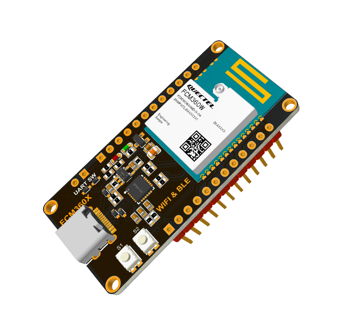

- FCM360W development board * 1
- USB Type-C data cable * 1
- Windows computer * 1
- Router with internet access capability * 1
- If the Wi-Fi module communicates with devices within the local network, there is no requirement for the router to have internet access.
- If there is no router, you can use a mobile phone hotspot. For iOS devices, please try to enable the hotspot's compatibility mode to avoid the Wi-Fi module from being unable to connect.
Connect the FCM360W development board to the computer using the USB Type-C data cable, and the development board will automatically power on and start running.

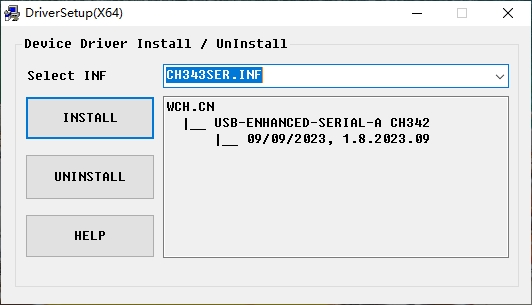

USB to Serial Driver - CH343SER
The FCM360W module does not have a USB interface but has two serial ports. To communicate with the computer, including firmware burning, Python command interaction, system log output, etc., a circuit with a USB to serial chip is required.
The FCM360W development board already integrates a USB to serial chip with the CH342 model. Visit the chip's official website to download the driver for the USB to serial chip. Click the INSTALL button to complete the driver installation in one step.
It's important to note that both CH342 and CH343 chips use the CH343SER driver to avoid unnecessary confusion between chip names and driver names.

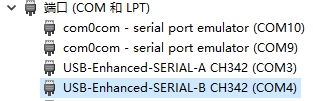

The CH342 chip can convert one USB to two serial ports. After the driver is installed, we can see in the Device Manager of the Windows computer that there are two serial devices with names starting with USB-Enhanced-SERIAL, as shown in the following image:
- Serial port
USB-Enhanced-SERIAL-A CH342is used for firmware burning and system log output. - Serial port
USB-Enhanced-SERIAL-B CH342is used for Python command interaction.

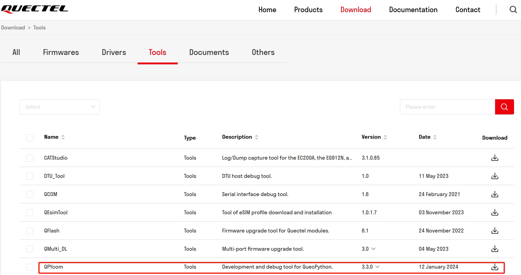

Integrated Development Tool - QPYcom
QPYcom is an integrated development environment designed specifically for QuecPython. It includes features such as Python command interaction, file transfer, firmware burning, and script execution.
Visit the download page on the QuecPython official website, and you can find QPYcom under the Tools tab for downloading. After extracting, double-click QPYcom.exe to open and use it directly.
Click here to view the tutorial on how to use the QPYcom tool, with a focus on the Download Function.

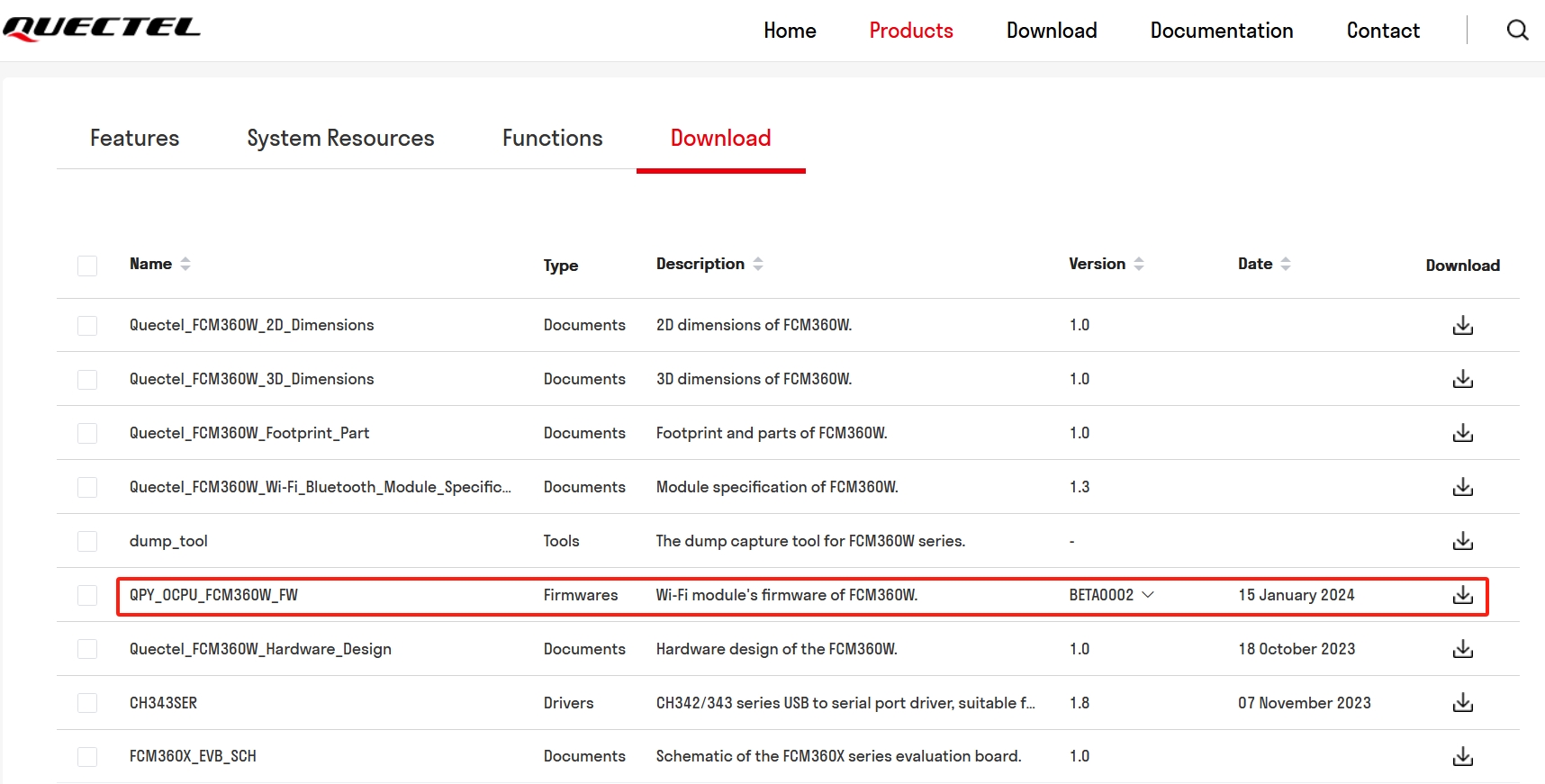

Download FCM360W Firmware
It is necessary to burn the FCM360W firmware package, which includes the QuecPython runtime environment, to execute QuecPython scripts.
Visit the QuecPython official website, go to the details page of the FCM360W module, and navigate to the Download tab. Find the download item named QPY_OCPU_FCM360W_FW, click the download button on the right, and you can download the firmware package.

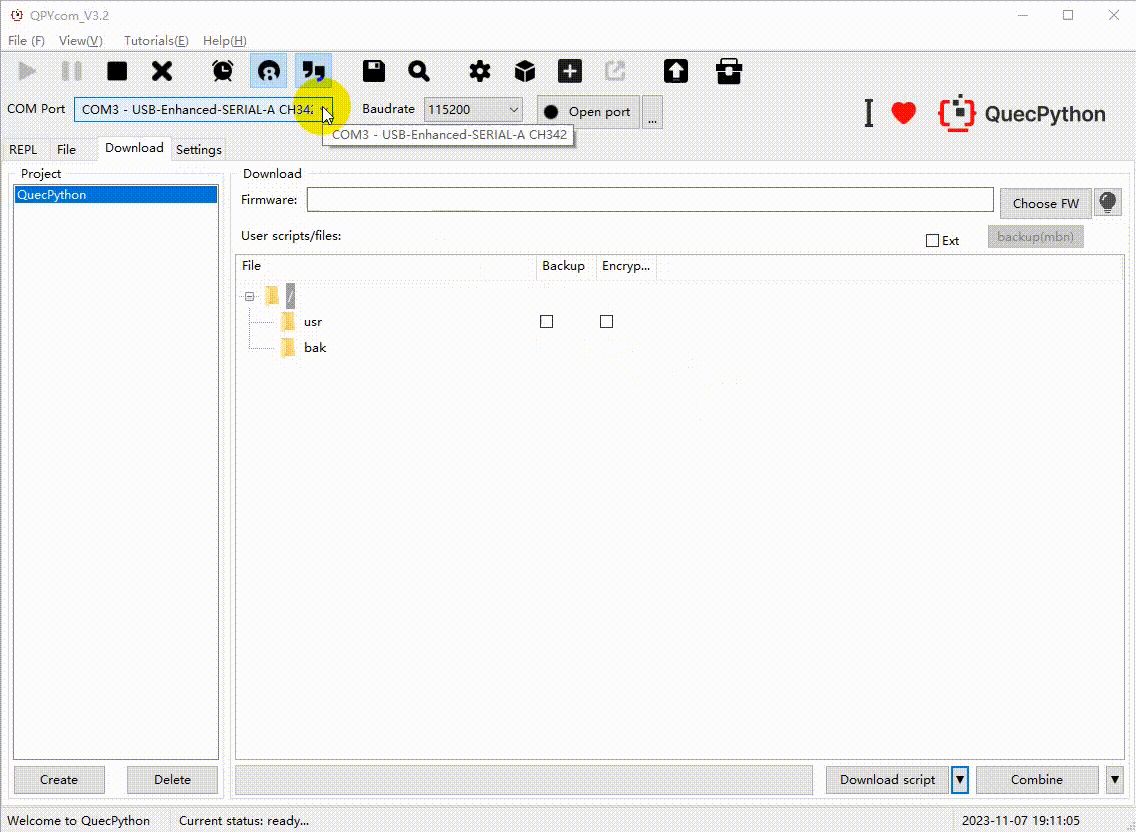

Burn FCM360W Firmware
Before starting the burning process, two things must be clarified:
- The firmware package downloaded directly from the QuecPython official website is in zip format. It must be extracted first, and the file
QPY_OCPU_BETA0002_FCM360W_FW.binunder theQPY_OCPU_BETA0002_FCM360W_FWfolder is the file to be burned. - The burning port is
USB-Enhanced-SERIAL-A CH342, with a baud rate of115200. The port must be opened before burning.
Then, follow the firmware burning process as shown in the image below.

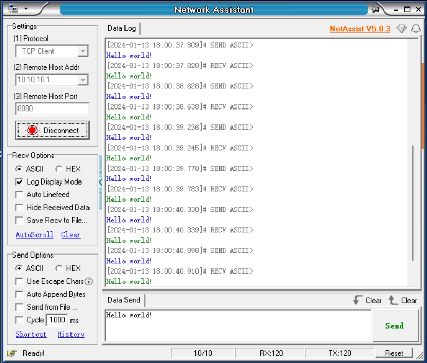

Network Application Development Process
Before we begin, it's important to note: when developing applications based on the TCP protocol in the Wi-Fi module, whether the module acts as a client or server, and whether it is in STATION or AP mode, is irrelevant.
For the convenience of case demonstration, this section demonstrates the implementation of two functions:
- Develop a TCP client in STATION mode, with the functionality to:
Connect to a TCP echo server, periodically send data to the server and receive its echoed data; repeat this process 10 times, disconnect from the server, and end the program.
- Develop a TCP server in AP mode, with the functionality to:
Accept connections from TCP clients and send back the data received from these clients.

To verify this functionality, you need to prepare a computer capable of connecting to the Wi-Fi hotspot and running a TCP client.
In this scenario, a network debugging assistant named NetAssist.exe is run on the computer.
The verification steps are as follows:
Implement the
tcp_echo_serverfunction in the software framework according to the provided code, creating a complete application.Save the code as a Python script file and import it into the Wi-Fi module using QPYcom, then execute the script.
At this point, the Wi-Fi module will create a hotspot and start the TCP server. The log will look like this:
- Created a Wi-Fi NIC. - Will create a AP: SSID: QuecPython_SoftAP PASSWD: 12345678 - Event: {'msg': None, 'type': 3200, 'id': 3201} - AP is created successfully. - Start TCP server. - Socket object created. - Bind address: 10.10.10.1, 8080 - Start listening ...Connect the computer to the Wi-Fi hotspot generated by the Wi-Fi module:
QuecPython_SoftAP.At this point, the module's output log will be as follows:
- Event: {'msg': {'mac': 'c4:75:ab:bc:a5:ac', 'aid': 1}, 'type': 3200, 'id': 3203} - Event: {'msg': {'ip': '10.10.10.2', 'aid': 1, 'mac': 'c4:75:ab:bc:a5:ac'}, 'type': 3200, 'id': 3205}Start the network debugging assistant NetAssist.exe and connect to the server started in the module:
10.10.10.1, 8080.At this point, the module's output log will be as follows:
- Accept a client: 10.10.10.2, 51434In the data sending area of NetAssist, enter the string
Hello world!and continuously click theSendbutton to send data to the server.At this point, the module's output log will be as follows:
- Recv data: [client addr: 10.10.10.2, 51434]: b'Hello world!' - Recv data: [client addr: 10.10.10.2, 51434]: b'Hello world!' - Recv data: [client addr: 10.10.10.2, 51434]: b'Hello world!' - Recv data: [client addr: 10.10.10.2, 51434]: b'Hello world!' - Recv data: [client addr: 10.10.10.2, 51434]: b'Hello world!' - Recv data: [client addr: 10.10.10.2, 51434]: b'Hello world!' - Recv data: [client addr: 10.10.10.2, 51434]: b'Hello world!' - Recv data: [client addr: 10.10.10.2, 51434]: b'Hello world!' - Recv data: [client addr: 10.10.10.2, 51434]: b'Hello world!' - Recv data: [client addr: 10.10.10.2, 51434]: b'Hello world!'Simultaneously, after each data transmission, the data reception area of the Network Debugging Assistant will display the sent data (in blue font) and show the data received from the server (in green font).
The running effect of the Network Debugging Assistant is shown in the following image:
