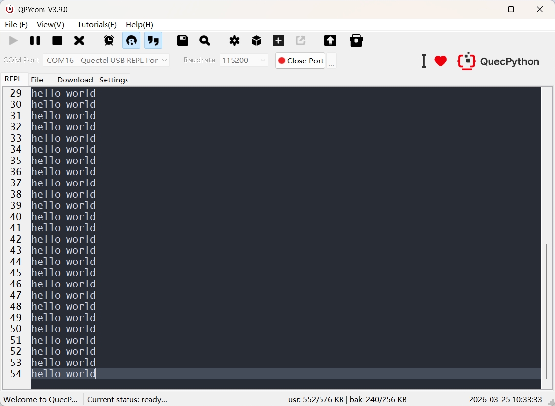

Test the Auto-Run Effect (Restart the Module to Verify Execution Results)
After the module is fully started, the hello world log is continuously output every second. This proves that the program is automatically executed upon module startup, and the verification of the auto-start function is completed.
image-2021081301
Note: If only the one-time execution code print("hello world") is written in main.py (without loop-based continuous running logic), the one-time print output will be generated before the REPL port is opened. As a result, QPYcom cannot capture the one-time print output.
