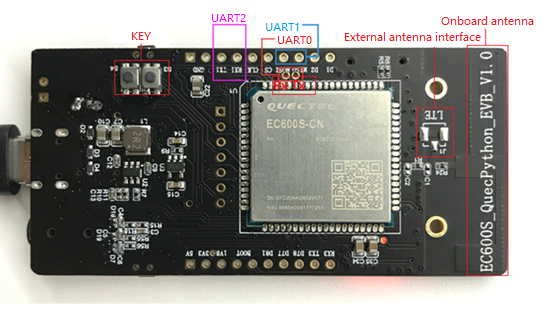

EC600S EVB and module serial port correspondence diagram
The serial port location of the EC600S EVB (EC600S_QuecPython_EVB_V1.x) is as follows:
